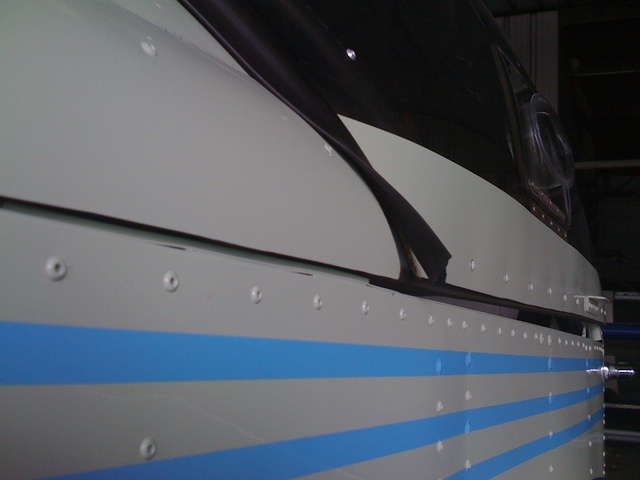

    The rubber molding that goes around the front of the canopy and over the little piece of metal that covers the canopy arm refuses to stay stuck down on my airplane. I've attached a picture. The airflow gets under the leading edge at the left end, and lifts it up. I tried sticking it down with contact cement, but it came loose on my last flight. Suggestions? -------- Jay Maynard, K5ZC AMD Zodiac XLi N55ZC Read this topic online here: http://forums.matronics.com/viewtopic.php?p 9393#209393 Attachments: http://forums.matronics.com//files/canopy_molding_130.jpg

    Hi Jay, Try Loctite Stick n Seal. You can get it at Wal*Mart - a 1 oz. tube is a couple of bucks. Look in the paint department. Good Luck, Paul At 03:23 PM 10/19/2008, you wrote: >The rubber molding that goes around the front of the canopy and over >the little piece of metal that covers the canopy arm refuses to stay >stuck down on my airplane. I've attached a picture. The airflow gets >under the leading edge at the left end, and lifts it up. I tried >sticking it down with contact cement, but it came loose on my last >flight. Suggestions? > >-------- >Jay Maynard, K5ZC >AMD Zodiac XLi N55ZC

    Jay Zenith recommends Loctite Stick'N Seal Waterproof adhesive P/N 23782 availabe at Wal-Mart and I have seen it at Home Depot. (Cheaper at Wal-Mart) I used that and also E6000. I think the E6000 works better. Floyd Wilkes 601XL O-200 Flying ----- Original Message ----- From: "jmaynard" <jmaynard@conmicro.com> Sent: Sunday, October 19, 2008 5:23 PM Subject: Zenith601-List: That %^#$%& canopy molding > > The rubber molding that goes around the front of the canopy and over the > little piece of metal that covers the canopy arm refuses to stay stuck > down on my airplane. I've attached a picture. The airflow gets under the > leading edge at the left end, and lifts it up. I tried sticking it down > with contact cement, but it came loose on my last flight. Suggestions? > > -------- > Jay Maynard, K5ZC > AMD Zodiac XLi N55ZC > > > Read this topic online here: > > http://forums.matronics.com/viewtopic.php?p 9393#209393 > > > Attachments: > > http://forums.matronics.com//files/canopy_molding_130.jpg > > >

    Your setup is a little bit different from mine, but I used 3M weatherstrip adhesive and have had no problem. Funny thing is, most of the pictures of planes I see on the Zenith website don't have the rubber going down that far. And this picture ( http://www.zenithair.com/zodiac/608/60935.jpg ) of the CH 650 from Oshkosh appears to have the lower end of the molding held down with screws. Since there no need for the molding to separate from aluminum in that area, I would suggest that you glue down the leading edge of the molding to the aluminum so that the airflow can't lift it. > > > > > The rubber molding that goes around the front of the canopy and over > the little piece of metal that covers the canopy arm refuses to stay > stuck down on my airplane. -- Bryan Martin N61BM, CH 601 XL, RAM Subaru, Stratus redrive. do not archive.
