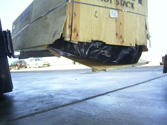

    Getting ready to order my canopy kit (650 style for XL). Does anybody have any experiences or horror stories regarding shipment of that big plastic bubble in the winter? Does it stand up well to the rigors of being bounced around on trucks & loading docks during the winter? I live in MN. Does anyone know the dimensions of the crate? Thanks, - Patrick -------- Patrick 601XL/Corvair N63PZ (reserved) Read this topic online here: http://forums.matronics.com/viewtopic.php?p=223026#223026

    Patrick, Last month, I went with a friend to Mexico, MO, to get his XL QB kit.? We loaded all the parts in a 22' truck, padded and tied down.? When we left Mexico, it was 16 degF.? The truck suspension was real stiff and all the roads seemed really rough. We bounced a lot!? The canopy bubble (and everything else) came through OK.? If you are having your's delivered, ZAC will crate it.? I can assure you that they know what they are doing when it comes to crating.? You have nothing to worry about, unless someone does something really stupid, like ramming the crate with fork truck forks, or dropping a crate from 6' up. Jay in Dallas Do not archive -----Original Message----- From: PatrickW <pwhoyt@yahoo.com> Sent: Mon, 5 Jan 2009 3:47 pm Subject: Zenith601-List: Canopy and Cold Weather (shipping) ? Getting ready to order my canopy kit (650 style for XL). Does anybody have any experiences or horror stories regarding shipment of that big plastic bubble in the winter? Does it stand up well to the rigors of being bounced around on trucks & loading docks during the winter? I live in MN. Does anyone know the dimensions of the crate? Thanks, - Patrick -------- Patrick 601XL/Corvair N63PZ (reserved) Read this topic online here: http://forums.matronics.com/viewtopic.php?p=223026#223026 ________________________________________________________________________ Email message sent from CompuServe - visit us today at http://www.cs.com

    shipping damage,you mean like this? Zenith was great and sent replacements for all the broken stuff as the shipping Co was at fault.. drove a forklift through the ends. Chris. Read this topic online here: http://forums.matronics.com/viewtopic.php?p=223068#223068 Attachments: http://forums.matronics.com//files/shipping_crate_649.jpg
