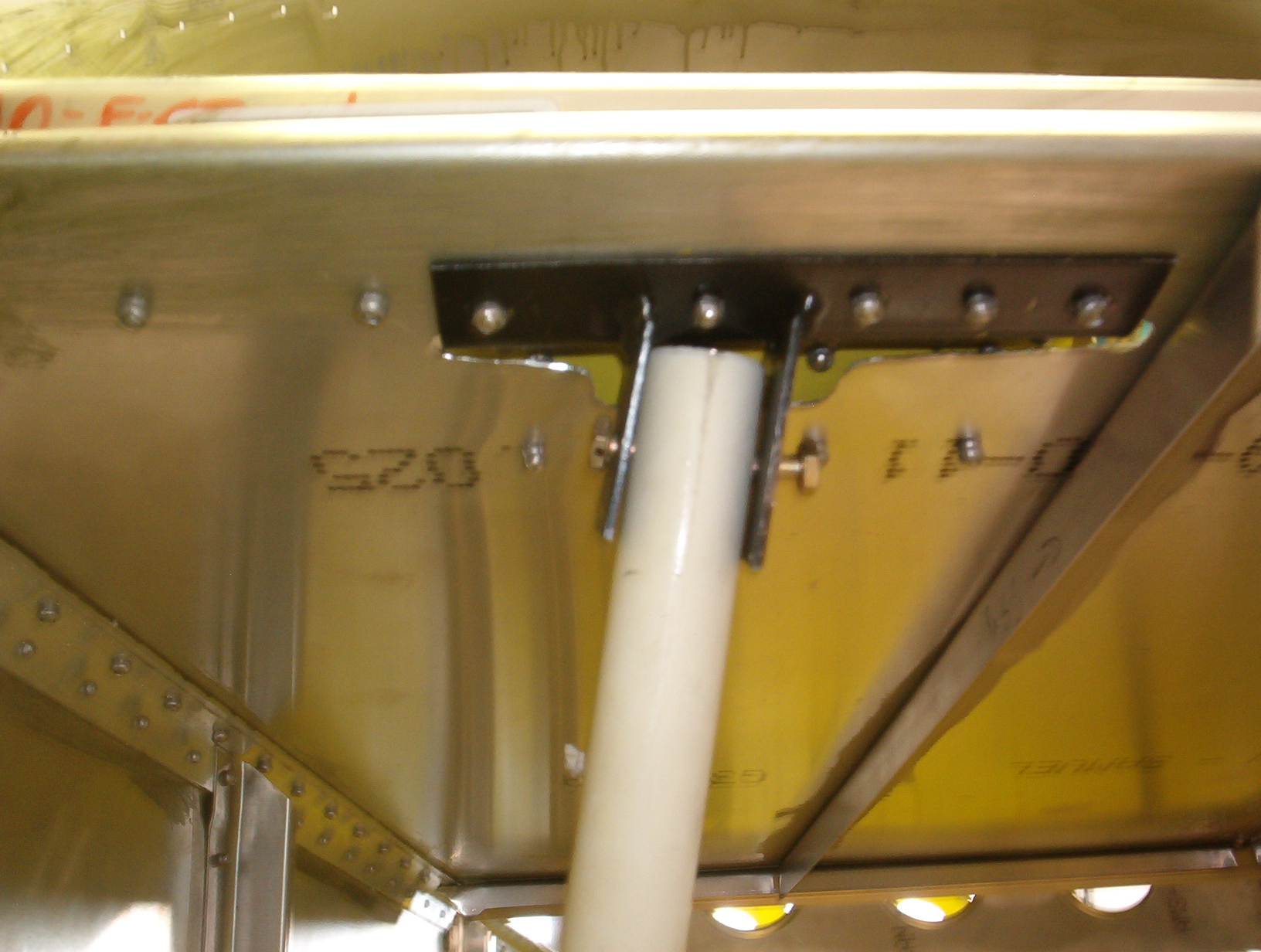

I can't really speak to factory support at this time since I finished my plane
3 years ago. It does seem that the 640 has been given little attention by Zenair.
Do make sure you have the rear seat plans that were updated. The seat is now
4 inches back from where it is in the prototype. This change was made about
4 years ago, and was included in my plans (#0052). It doesn't interfere with
the flap motor, but you do have to design your own way of attaching the steps,
as the bracket sent with the kit does not work as shown in the drawings. I attached
a few photos of how I did it without changing the brackets. While not elegant,
this method has held up fine over 600 hours.
Just a hint; use about 1 1/2 inch of high quality foam on the rear seats to maximize
space and 1 normal sized adult is pretty comfortable in back.
