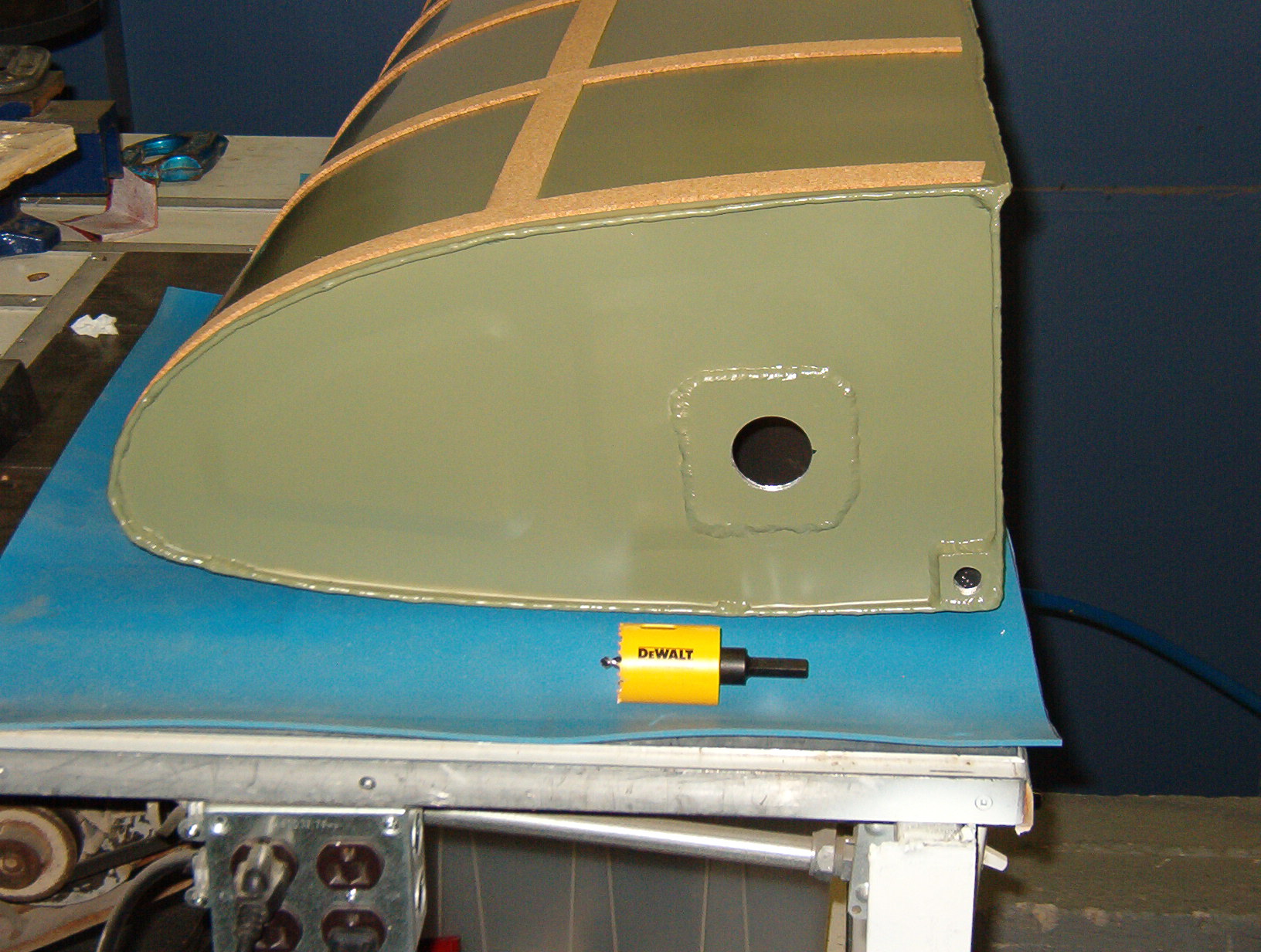

Chris, I have yet another question. From the photographs, I see that the fuel float
assy. is not installed. I'm guessing that the small welded panel on the side
is the base for installing the the float assy?

Hi Craig,
Your right, this small plate is for attaching the fuel sensor with 3/16 metal screw
x 5/8 of an inch (24 tread). The hole was done with a 1 5/8 Dewalt hole drill
cut off remover. This plate is done with a square piece (3 x 3 inches) with
a 0.125 piece of 6061-T6 welded to the tank skin. See photographies attached.

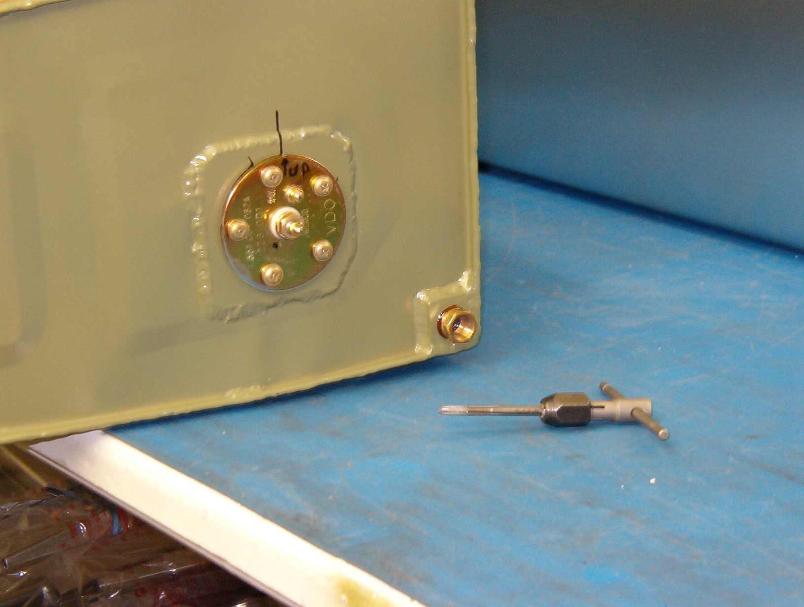

Additional info:
Rectification it is not exactly metal screw that should be used, but metal bolt
with cross head for tightening with a screw driver tool. You should do hole
with tread with a left hand tap tool.

http://forums.matronics.com/viewtopic.php?p=210704#210704
http://forums.matronics.com//files/im001613_651.jpg
