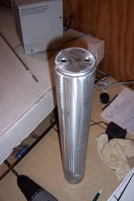

    My reason for not wanting the extra wing tanks is the extra wiring, plumbing, panel space and weight, even empty they weigh something. With the G13 or BMW engine the flying hours are quite a few more per tank due to lower fuel burn. How much more, time will tell and so will I when I find out. But until then its all BS (baloney sausage, of course [Wink] ) Kevin -------- Mark Twain: Twenty years from now you will be more disappointed by the things that you didn't do than by the ones you did do. So throw off the bowlines. Sail away from the safe harbor. Catch the trade winds in your sails. Explore. Dream. Discover. Read this topic online here: http://forums.matronics.com/viewtopic.php?p=187813#187813

    This is a pic of a highlander sub-tank. It has two inputs from the wing tanks on top and one on the bottom. There is no vent to the wing tanks. But it is a carburated engine so the pump is not returning fuel to the tank all the time. Kevin -------- Mark Twain: Twenty years from now you will be more disappointed by the things that you didn't do than by the ones you did do. So throw off the bowlines. Sail away from the safe harbor. Catch the trade winds in your sails. Explore. Dream. Discover. Read this topic online here: http://forums.matronics.com/viewtopic.php?p=187814#187814 Attachments: http://forums.matronics.com//files/100_0811_164.jpg
