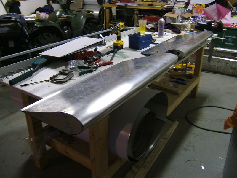

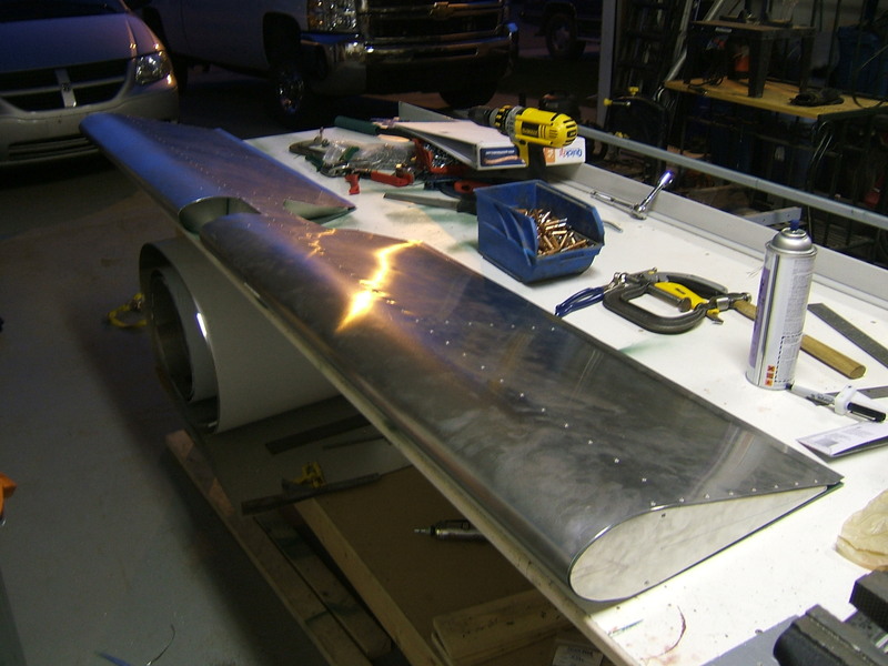

    Got my second scratch built component done today, my elevator is now ready for it's pre-cover inspection. Here are a couple of pictures. Now I'll be moving on to the horizontal stabilizer. -------- Scratch building a 701. Rudder complete. www.mykitlog.com/rengler Read this topic online here: http://forums.matronics.com/viewtopic.php?p=190673#190673 Attachments: http://forums.matronics.com//files/elevatorriveted2_516.jpg http://forums.matronics.com//files/elevatorriveted1_205.jpg
