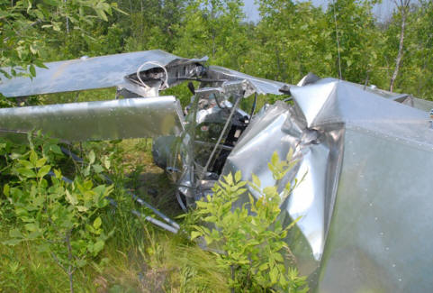

Slamming the engineering is rather arrogant unless you are a structural engineer
and even then there are better ways to discuss the strength of a system. Since
CH has experience in structural engineering, I'd be more likely to ask the
question to him rather than making negative comments as to competency on the list.
I've attached a photo of the field tested seat belt attachment. The collision with
the terrain resulted in crumpled distortion of the fuselage NOT the bolt pulling
through the attachment. I'm more likely to assume that the structural engineer
has calculated considerations of the strength of the fuselage and its
characteristics under heavy loads. This crumpling seems to have some good features
in that the pilot receives less bodily damage due to an immovable seat belt
system.
Cal
n85ae wrote:
> Something to think about, because Zenith sure did not do their engineering
> calculation with regard to the seatbelts.
> I calculated the stock 801 seat belt tabs at 200lb.s at 10G's in shear, if
> indeed the rivets don't pull out before that. So I replaced them with 4130
> steel the same thickness which I bolted with AN3's to the fueslage longerons.
I also added structure to the center console.
> Crash impacts can go up to 40/50G's and be survivable, so I'm not sure
> what they were thinking when the designed the stock ones. But they were
> not designed to handle more than the bare minimum.
> I suppose if I crash that hard I might not survive anyway, but I sure don't
> want to leave on account the seat belt tabs sheared.
> Jeff

| Subject: | Re: Shoulder Harness attachment |
Cal -
Glad you qualified that with "unless you are", because I hate being called
arrogant.
Jeff
list.
with the terrain resulted in crumpled distortion of the fuselage NOT the bolt
pulling through the attachment. I'm more likely to assume that the structural
engineer has calculated considerations of the strength of the fuselage and its
belt system.

Meaning, yes I am an engineer.
Jeff
