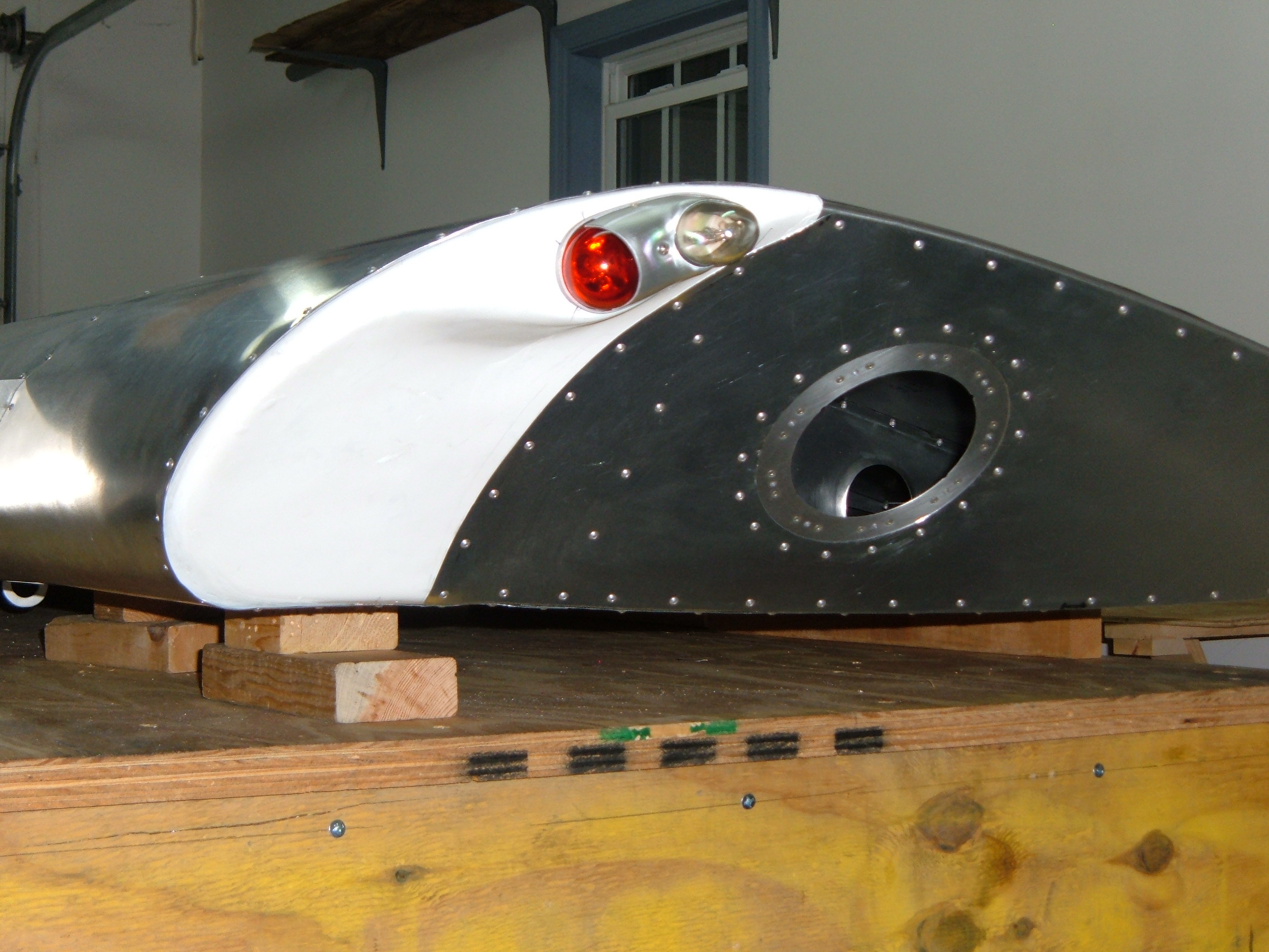

Where is everyone installing their inspection plates for the wings? I called ZAC
and they referred me to the Construction Standards on the website, which basically
tells me nothing.
I'm thinking an inspection plate should be installed between the third and fourth
rib to inspect the strut attachment points and another installed near the tip
(maybe on top?) to inspect/repair the nav/strobe lights. Where is everyone
else putting theirs (if any)?
Dan Ginty
N787DG
90% complete for a long,long time

I went with small (100mm dia) inspection plates for the strut attach points as
