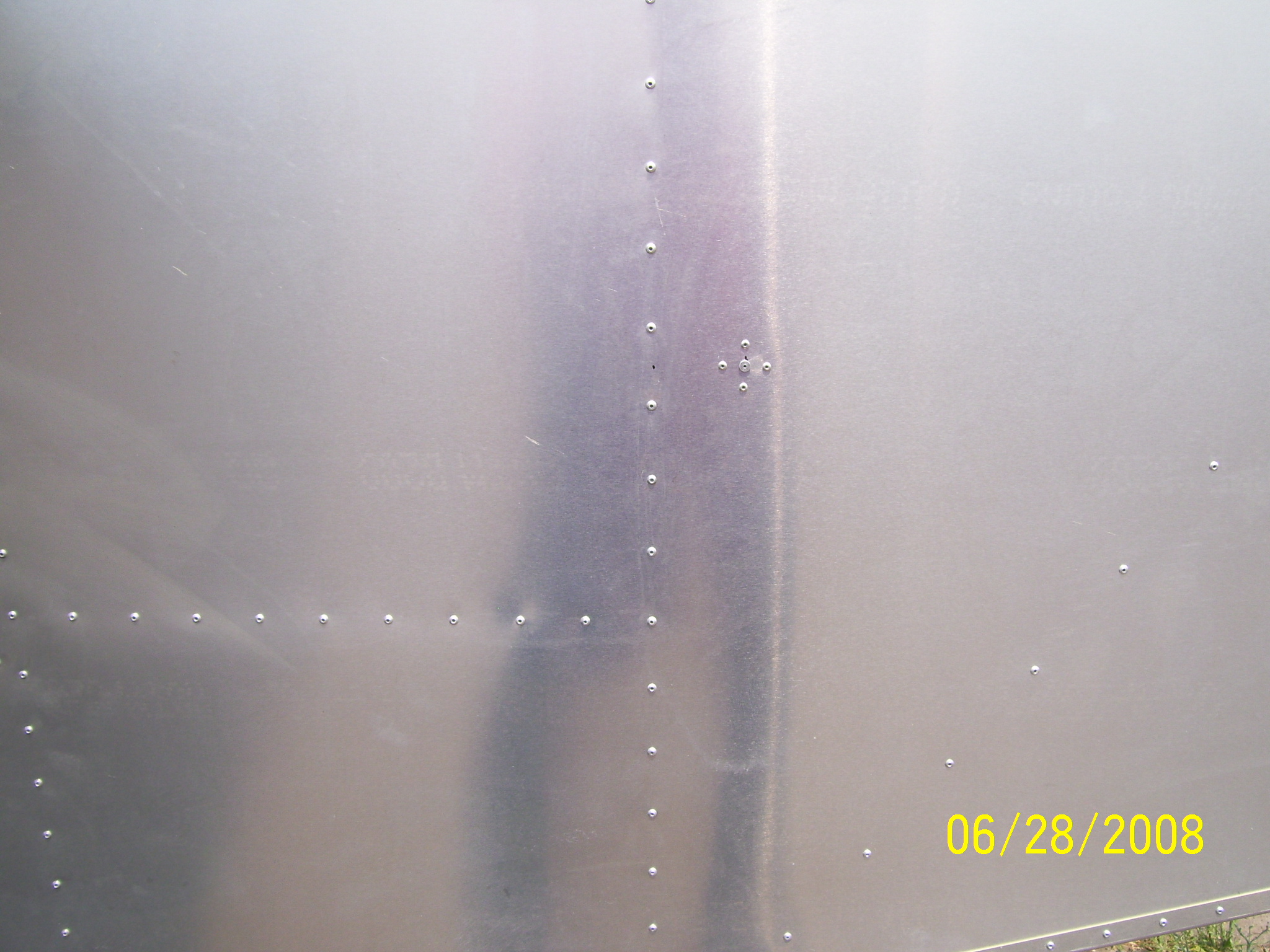

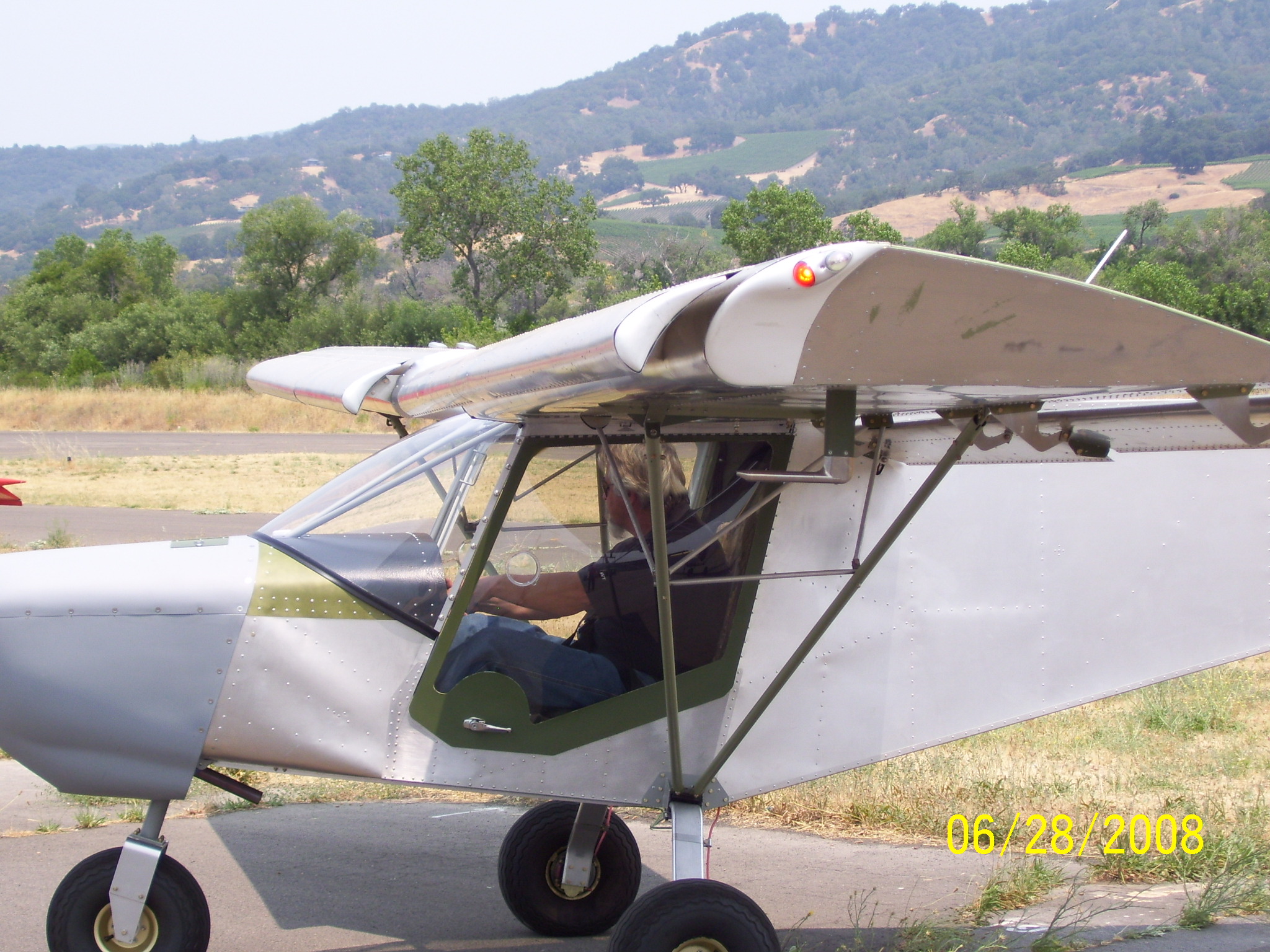

All,
Here is a couple of pictures I took of 701ZB, when I was out in Quality Sports
in Cloverdale, CA.
The pictures show his just a little bit behind the baggage rivet line. Can not
remember the gentleman's name, but he did point the static port out to me and
said he has good luck with it. He flies with a Flightdeck D-180 (Dynon)
Just FYI
Keith

of the cabin below the doors (better but still off). Finally I looked at what
others has done and moved the two endings about two feet behind the doors
just under the baggage compartment outside the cabin. The results now are in
sync with the GPS at any airspeed.

All, did the pictures of the static port location come thru?
I didn't even see my reply come through. This is the first response I saw come
back, and I only assumed that, because of the 701ZB register, (thanks Craig)
Keith

If you didn't get them here are links into the web-based forums:
http://forums.matronics.com/viewtopic.php?t=49792
http://forums.matronics.com/download.php?id=12714
http://forums.matronics.com/download.php?id=12715
-- Craig
