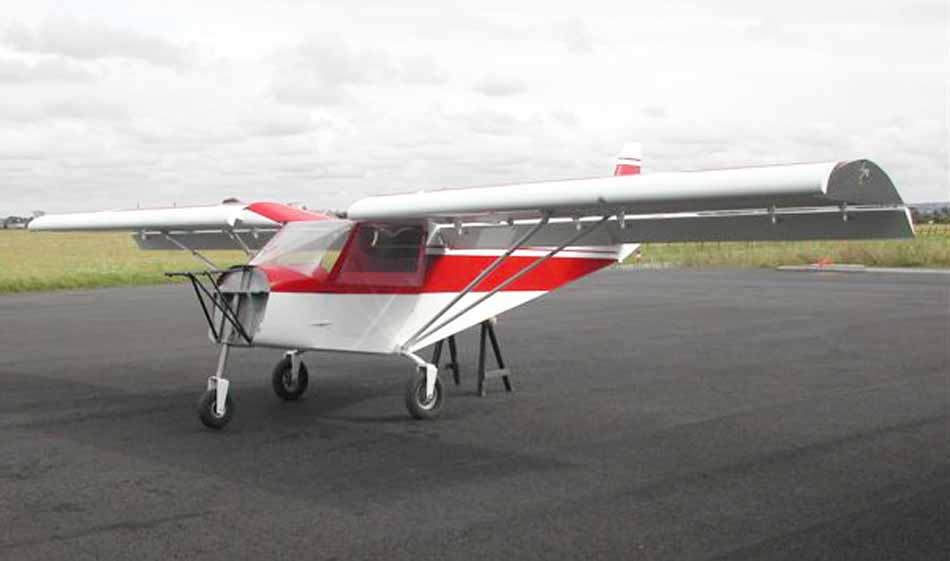

Hello
I 'm interested to buy a 701 , already built (airframe & wings) but not finished.
a picture of it is attached.
it's a kit aged about 10 / 12 years (I think so ?) and my question is :
are there important aerodynamics changes with the new 701 models ?
will that change something with its performance ?
thank you !

I dont think there is any aerodynamic changes from the earlier model, the max.
weight is limited to 960 lbs and there are more restrictions on engine type and
weight. The rev-4 plans had a lot of changes to the wing spars and attach points
to enable a weight increase to 1100 lbs so the more favoured engines like
912S could be used more fully. Flap travel is now restricted to 16 deg as the
heavier models dont need as much.
There are lots of the lighter ones flying well on the 80hp Rotax or less, so it
will come down to what mission you have, how much stuff you need to install and
what the crew weights are.
Ralph
