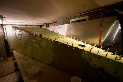

    Time: 02:46:25 PM PST US
    From: "John Marzulli" <john.marzulli@gmail.com>
    Subject: Re: Additional L angles in fuselage.
    Kinda like what I have done? http://3.bp.blogspot.com/_mhDbWUJRTOE/RxW3sp5NmnI/AAAAAAAAC_g/F6K9oqBnoAQ/s1600-h/IMG_3413.jpg Here you can see one of the spots where I installed some sound deadening material: http://3.bp.blogspot.com/_mhDbWUJRTOE/RxsWJJ5NmrI/AAAAAAAADAU/rXSuCYd_TtY/s1600-h/IMG_3425.jpg John Marzulli http://www.GenevieveMarzulli.org/ http://marzulli.smugmug.com/ http://701Builder.blogspot.com/ http://www.JohnMarzulli.net/ On Tue, Jan 6, 2009 at 2:14 PM, Curt Thompson <Curt.Thompson@verizon.net>wrote: > Curt.Thompson@verizon.net> > > I'm going against the norm and do mine with single diagonal braces of a > square truss like is shown in the following link: > http://www.supplierlist.com/photo_images/32654/Truss.jpg > > I'm going to use .016" AL with about 50mm rivet spacing. I will try to tie > them into the corners. > > Curt > Plans building CH701 > > -----Original Message----- > From: owner-zenith701801-list-server@matronics.com > [mailto:owner-zenith701801-list-server@matronics.com] On Behalf Of Harvey > Richards > Sent: Sunday, January 04, 2009 12:17 PM > To: zenith701801-list@matronics.com > Subject: Zenith701801-List: Re: Additional L angles in fuselage. > > <lisa.richards@ns.sympatico.ca> > > Have decided to follow the norm and go with the X bracing . I can see the > advantage to tying the top and bottom longerons together on the diagonal > and > the four smaller triangles between the Ls should be stronger. > > -------- > CH 701 > >
