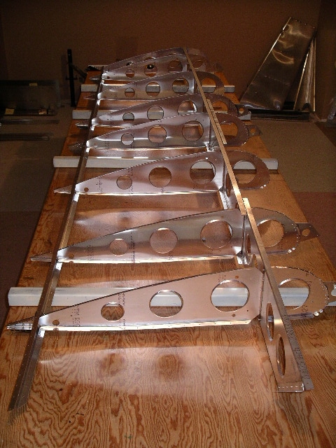

Message 3
Here is a pic of a Savannah wing. The Spar doubler is .025 instead of .032 and
it is about 500mm longer I also have the instructions to upgrade the Savannah
to 1200 gross they do not include changing the doubler. Mostly the attach point
and some mods to the fuselage.Also attached is the extended spar on a 701.
I have a folder called long wing share for anyone interested, to big to post here.
Kevin

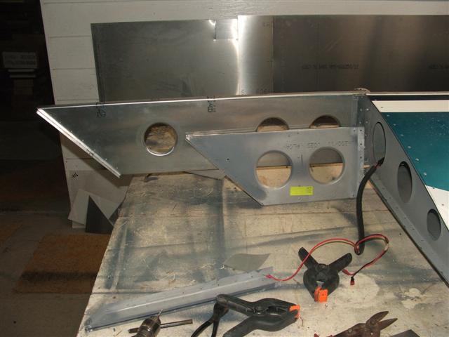

Randall, It looks' as though my attempt to merge my reply to your previous message
was not a success, so I will try this once again.
Robert
I am a little younger than you (9 months)
Nine months makes you close enough to be in my club. :o) welcome
I think the question posed earlier was are you planning to add the 16 inches inboard
of the slats.
I am a little confused about your use of the word " slats " . Should I read that
as being " struts " rather then your use of slats, if that is the case, yes,
inboard of the strut attachment on the wing
Meaning will you be building a longer SPAR?
I have already cut the spars out of .032 to a total length of 3660m
One response asked if you were using the Zenith spar or are you building one from
scratch.
I am riveting my own. I purchased a 3X from " Cleveland ", along with their new
12" back rivet setter, and first impressions are very positive
The answer lies in the method of construction. Since the sketch was for the tip
end or outboard end it simply added an extender.
The tip end is not structurally attached.
That is one reason I am not inclined to go with anything that does not add structurally
to the wing. I also plan on extending my spar caps as far into the spar
tip as I can
Adding 16 Inboard or at the root can only be accomplished if you are building from
scratch.
Definitely from scratch. My disability pension dictate's it can't be done otherwise
There are structural issues that you need to be aware of if this is so
Randall, as you can see, " This is so " so would you care to elaborate on what
additional issues I should know about. ?
I will speak to you later this evening, because I am going into my " hanger " (
read that as being my basement ) to skin my stabilizer. This is also something
to which I added my own touch. For what it's worth, the mods I have made to
the stab, were done before the plans for the 750, were made available. Check
attached pic for the two views
Robert Pelland
701 & 750 Scratch
Trois Rivires, Qubec
819 377-2492
Thank you for your input, and fly safe
Live each day, as if it was your last
http://forums.matronics.com/viewtopic.php?p=232193#232193

Message 6
Good morning Kevin,
I am not quite sure what reinforcement you are referring to, since I
posted a photo showing two different configuration of the stabs, that
are not quite like the factory design for the 701.
If you are referring to the short 45 degree angles I riveted to the tip
ribs on the original model, it was simply done to keep everything
squared up perfectly for the skinning. These small sections have no use
what so ever, once the skin is in place and riveted correctly.
On the other hand if it's the double spar modification you are talking
about, I reinforced the stab in this way to try and diminish the
destructive actions caused by the violent shaking that is seen at low
engine speed, or when it is flown from the water. I also replaced the A4
rivets with the stronger A5 on the tip ribs, since these ribs are all
that hold the outer hinges to the stabilizer
My original thoughts were that it most certainly be much more resilient
in this way, and it seems that my impressions were not far off. The
reason I say this is because not long after assembling the stab in this
fashion, I received my plans for the 750, only to see that the factory
had re-designed the stabilizer for the new CH-750 in the exact same way
I built mine for the 701, albeit mine is the standard length. There is
a very small weight increase, but you would not believe how strong the
bare frame is, as compared to the standard build.
Hope this answers your question, :o)
Best regards
Robert Pelland
The 701 & 750 Scratch

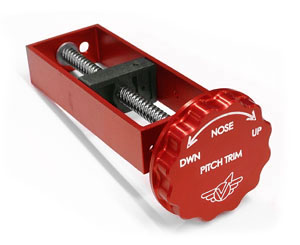

Message 8
| Subject: | Re: 701 elevator trim option |
Funny thing is I program, modify and repair automated machinery and the one thing
its taught me is simple is better!
Here is what I was thinking of using.
Kevin
Mark Twain: Twenty years from now you will be more disappointed by the things that
you didn't do than by the ones you did do. So throw off the bowlines. Sail
away from the safe harbor. Catch the trade winds in your sails. Explore. Dream.
Discover.

pics, when the time comes to start assembling ( still a little ways off
) the main wings.
Most of my apprehensions about the modifications, and extended wing,
disappeared after speaking to Caleb, a month or so ago, since his
remarque's sounded as though what I was considering was an everyday, run
of the mill thingy.
You have my best regards
Robert W. Pelland
Kevin,
I like the photo of manual trim control mechanism you posted, but my
main worry would be how quick changes could be made in case of a "
go-around ".
I actually started looking at a system for manually controlling the trim
tab to get away from the delay that is seen when using an electric trim
controller. I would expect that the one you have just included in your
response, might take quite a few turns ( I only have two hands ) to get
the trim back to it's take off position.
My past experience ( although limited ) has taught me that when landing
in conditions that are not necessarily ideal, my two hand and two feet
are very busy, so I would not want to be obliged to have to spend too
much time turning the knob one way or the other, to try and get the trim
tab, back to it's take off position. However in straight and level
flight, the use of a screw type of controller would make fine tuning a
pleasure.
Maby it's just me,,,, and thank's for the pic :o)
regards
Robert
the one thing its taught me is simple is better!
Kevin
things that you didn't do than by the ones you did do. So throw off the
bowlines. Sail away from the safe harbor. Catch the trade winds in your
sails. Explore. Dream. Discover.
http://forums.matronics.com/viewtopic.php?p=232202#232202
http://forums.matronics.com//files/trim_system_2289_298.jpg

Hey Robert
How thick is the front stabilizer reinforcement... 0.025 or 0.032 [Exclamation]
Ron
http://forums.matronics.com/viewtopic.php?p=232229#232229
Message 16
Ron,
I made mine out of .020, since I am not using any .016 anywhere on my
701 build.
As for the 750, I figure due to it's increased width, and weight of the
aircraft, the factory chose to use .025 on the front, and .032, in the
rear.
regards
Robert
