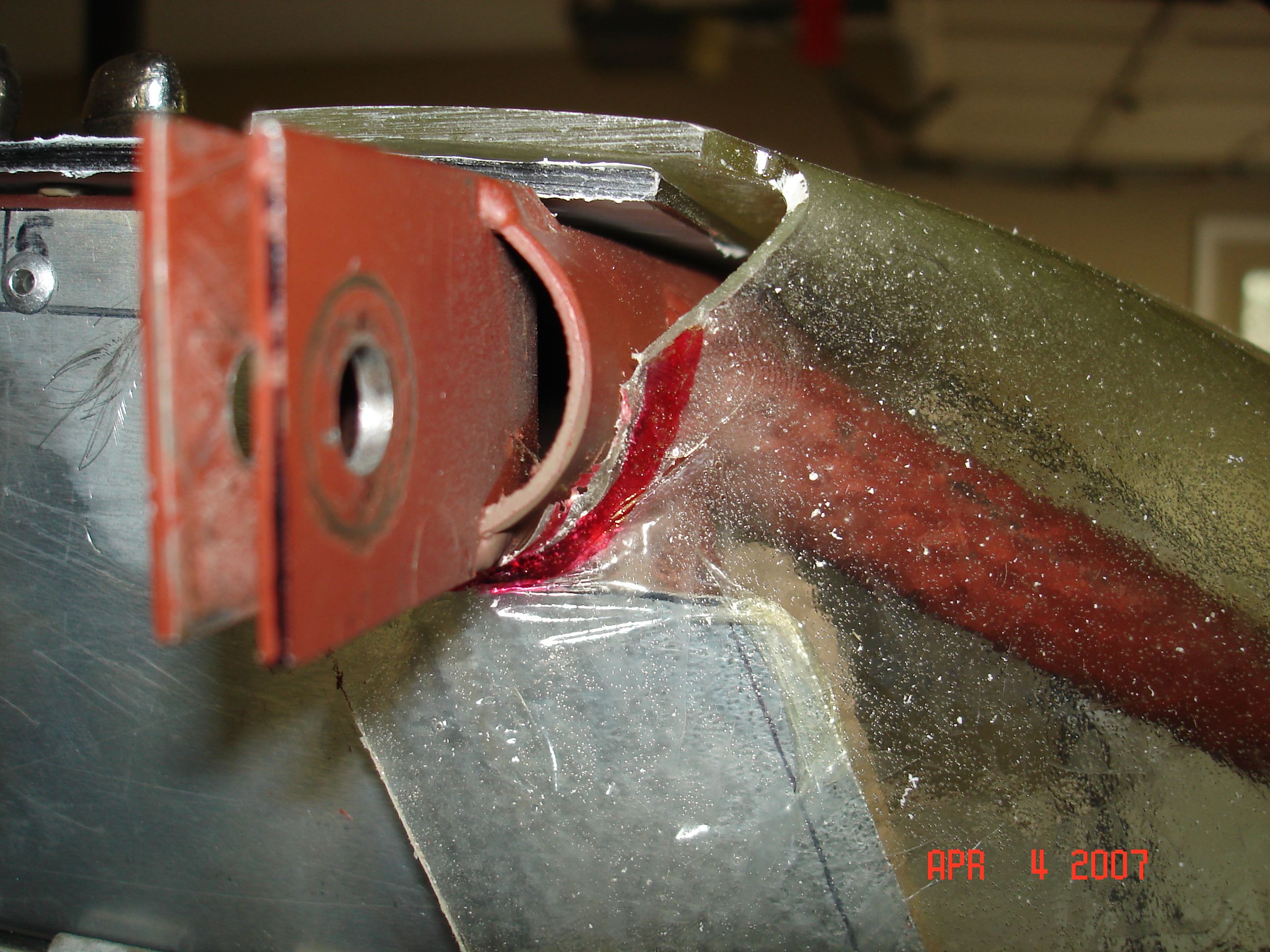

    Doug, There's not a lot of info available on the top window installation. I'm attaching a picture (I hope) of how the top window sits on top of the cabin frame underneath the windshield lip. We used a seam of acrylic (or some such) to seal the area. No drilling in the top cabin frame. Hope this helps Tommy Walker in Alabama -------- Tommy Walker N8701 - Anniston, AL Read this topic online here: http://forums.matronics.com/viewtopic.php?p=238458#238458 Attachments: http://forums.matronics.com//files/dsc00022_138.jpg

    Hi Philip, I'll wager it is hotter and sunnier here in Alabama. We considered adding some type of sun screen to the top window, but never did. The window is slightly tinted anyway, so we just went with that. It never seemed to be a problem. We always wore hats. Tommy Walker in Alabama -------- Tommy Walker N8701 - Anniston, AL Read this topic online here: http://forums.matronics.com/viewtopic.php?p=238459#238459

    do not archive Several yeas ago somebody suggested that the top window be totally fitted,clecoed, etc, BEFORE working on the piece which makes the window bow upward. (Don't have plans at hand, no part number for reference). Anyway, the idea being that the "curved" piece needs to apply a slight amount of upward pressure against the underside of the top window, and that attaching it last allowed the builder to position this piece as needed to achieve the desired result. As I recall, whoever suggested this explained that the curved piece, in his case, had a narrow strip of felt glued to the top, making contact with the bottom of the window. Seems that the Lister also mentioned he had seen others without any actual upward pressure, and they "fluttered" somewhat at various speeds, which dinged the window. You results may differ. Regards to all, Zed/701/912/90%, etc

    While flying it would bow outwards with the gigantic suction on the top of the cabin. I was worried it would be sucked right off! Then I put a strip of cork on the underside of the plexiglass along the diagonal brace and then glued it down to the diagonal brace with a strip of silicone and its fine, now. Doesn't move. ----- Original Message ----- From: "Zed Smith" <zsmith3rd@earthlink.net> Sent: Thursday, April 09, 2009 7:10 AM Subject: Zenith701801-List: re: top window > <zsmith3rd@earthlink.net> > > do not archive > > Several yeas ago somebody suggested that the top window be totally > fitted,clecoed, etc, BEFORE working on the piece which makes the window > bow upward. (Don't have plans at hand, no part number for reference). > Anyway, the idea being that the "curved" piece needs to apply a slight > amount of upward pressure against the underside of the top window, and > that attaching it last allowed the builder to position this piece as > needed to achieve the desired result. > As I recall, whoever suggested this explained that the curved piece, in > his case, had a narrow strip of felt glued to the top, making contact with > the bottom of the window. > Seems that the Lister also mentioned he had seen others without any actual > upward pressure, and they "fluttered" somewhat at various speeds, which > dinged the window. > > You results may differ. > > Regards to all, > > Zed/701/912/90%, etc > > >

    I live in southern Arizona and it is very sunny here and hot too. I put limousine tint (very dark) on the inside of my roof panel to keep from baking. It was like a solar oven in there. If I had to do it again the top would be all aluminum with maybe a small window that could be covered easily from the inside when sunny. My thought was that the plastic in a solid frame needed some room to move so it wouldn't crack. I made the holes in the plastic a little bigger then the screws shank. I did drill, tap and screw my Lexan down instead of rivet it, that way I could control how much to tighten the screws. I put Locktite on the threads and silicone under the heads of the #6 screws to keep the not real tight screws from turning and to keep the water out. One other thing to think about is the fact that that part of the cabin creates lift when in flight. I can stick my finger between the cross bow and the plastic when in flight yet it is tight to the cross bow when on the ground. This makes me think it needs to be attached quite well. -------- Ron Lee Tucson, Arizona Read this topic online here: http://forums.matronics.com/viewtopic.php?p=238482#238482

    Yes, it was the bowing out in flight that bothered me. I was worried that sooner or later there'd be a pop and swoosh and it would break and depart. That's why I fastened it to the cross tube. Maybe not necessary, but I relax better now. ----- Original Message ----- From: "ronlee" <rlee468@comcast.net> Sent: Thursday, April 09, 2009 8:45 AM Subject: Zenith701801-List: Re: Top window > > I live in southern Arizona and it is very sunny here and hot too. I put > limousine tint (very dark) on the inside of my roof panel to keep from > baking. It was like a solar oven in there. If I had to do it again the top > would be all aluminum with maybe a small window that could be covered > easily from the inside when sunny. > My thought was that the plastic in a solid frame needed some room to move > so it wouldn't crack. I made the holes in the plastic a little bigger then > the screws shank. I did drill, tap and screw my Lexan down instead of > rivet it, that way I could control how much to tighten the screws. I put > Locktite on the threads and silicone under the heads of the #6 screws to > keep the not real tight screws from turning and to keep the water out. > One other thing to think about is the fact that that part of the cabin > creates lift when in flight. I can stick my finger between the cross bow > and the plastic when in flight yet it is tight to the cross bow when on > the ground. This makes me think it needs to be attached quite well. > > -------- > Ron Lee > Tucson, Arizona > > > Read this topic online here: > > http://forums.matronics.com/viewtopic.php?p=238482#238482 > > >
