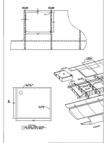

    Subject: Re: Fuel level sender and tank removal with 7-WTA-1
    cover What is the wta tank cover. I emailed zenair last week asking about an access panel on the top of the wing because I have serious issues burying the fuel tank. I was told no panel on top but I could make the top skin in two pieces and put an access on bottom between root and no.1 rib. Curious if anyone has seen other options. Mike 701 scratch Sent from my iPod On Oct 23, 2009, at 3:16 PM, "kmccune" <kmccune@somtel.net> wrote: What is the reason for moving the fuel sender to the side? It seams at the very least more leak proof on top. And for those with the optional 7-WTA-1 wing tank cover two questions: Can you remove the tank easily through the opening? Can you use two per wing for dual tanks? I ask because I am thinking of a second set of covers just in case I want to add a second set of tanks later. Thanks Kevin -------- History is a great teacher if you take time to study it. Steve Bennett Read this topic online here: http://forums.matronics.com/viewtopic.php?p=269137#269137
    cover
    From: "kmccune" <kmccune@somtel.net>
    In didn't even check if this is still an option. It was emailed to me. But her is what I have. Kevin -------- History is a great teacher if you take time to study it. Steve Bennett Read this topic online here: http://forums.matronics.com/viewtopic.php?p=269275#269275 Attachments: http://forums.matronics.com//files/wta_116.jpg
