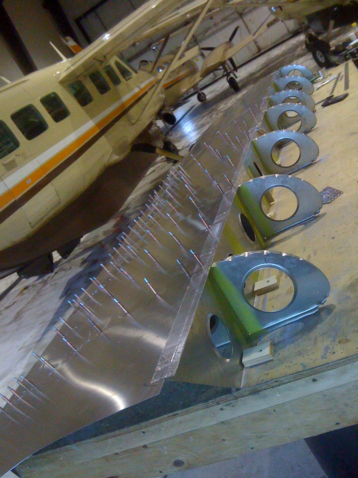

Just split the skin (lap joint) at the rib outboard of where the aux. tank goes
that way you have one section of wing skin that can be removed that will expose
both tanks and pluming behind the tank support and the plumbing at the main
tank..... fuel leaks are a pita and there is no better insurance than easy access
in my opinion
http://forums.matronics.com/viewtopic.php?p=270548#270548
