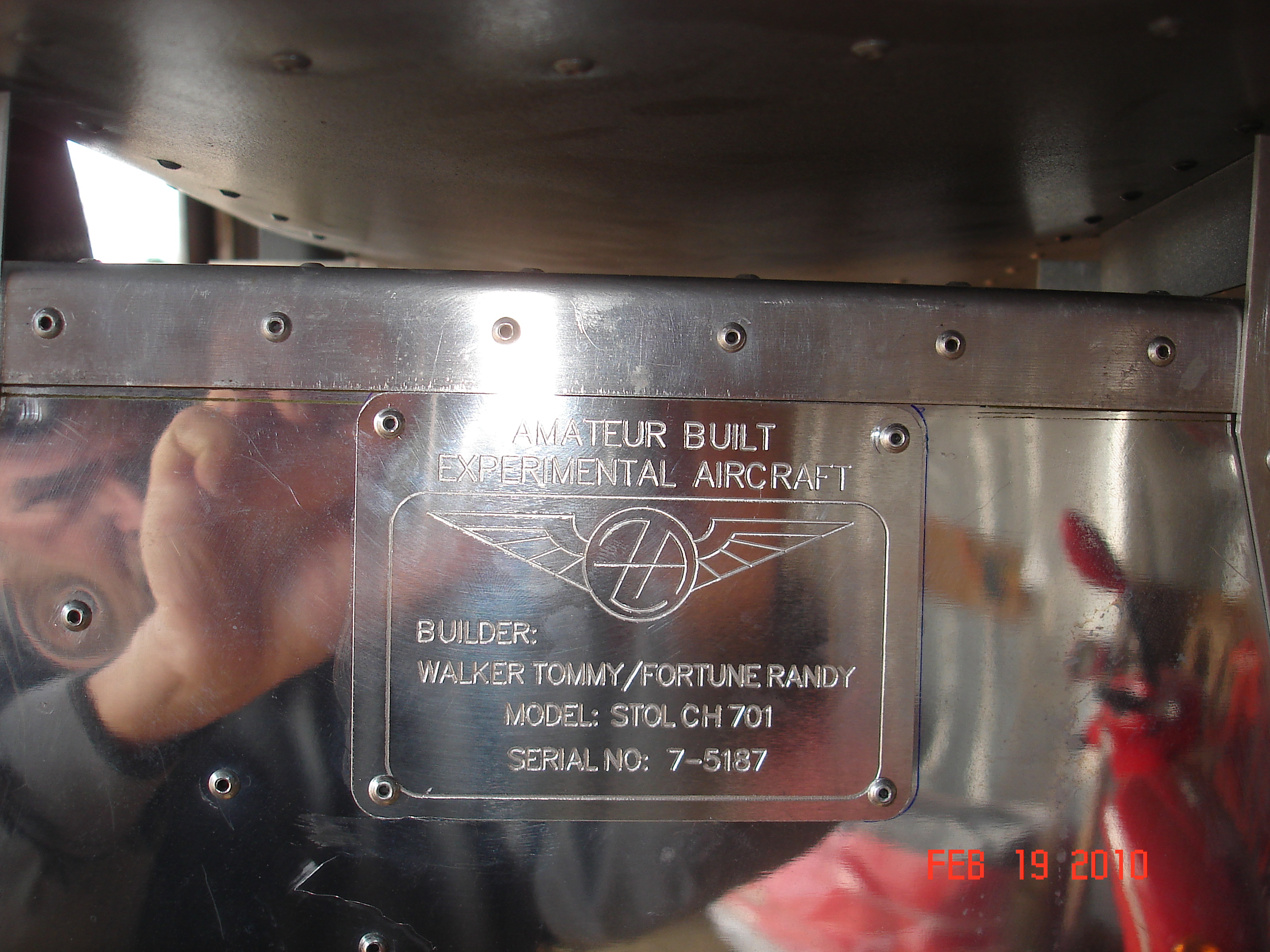

Congrats Tommy
Mine has been delayed but I am using yours as a goal
Randall J Hebert
N7701P
Almost Finished, Yea right
-----Original Message-----
From: owner-zenith701801-list-server@matronics.com
[mailto:owner-zenith701801-list-server@matronics.com] On Behalf Of Tommy
Walker
Sent: Sunday, February 28, 2010 6:10 PM
Subject: Zenith701801-List: Data Plate
<twalker@cableone.net>
Folks,
We had our DAR inspection yesterday and passed! Yea!
George Race made me a data plate with his CNC machine. The DAR was really
impressed with it.
If you are looking for a data plate for your project I recommend George and
his CNC machine.
Tommy Walker
N8701 - Anniston, AL
http://forums.matronics.com/viewtopic.php?p=288664#288664
http://forums.matronics.com//files/21_191.jpg
