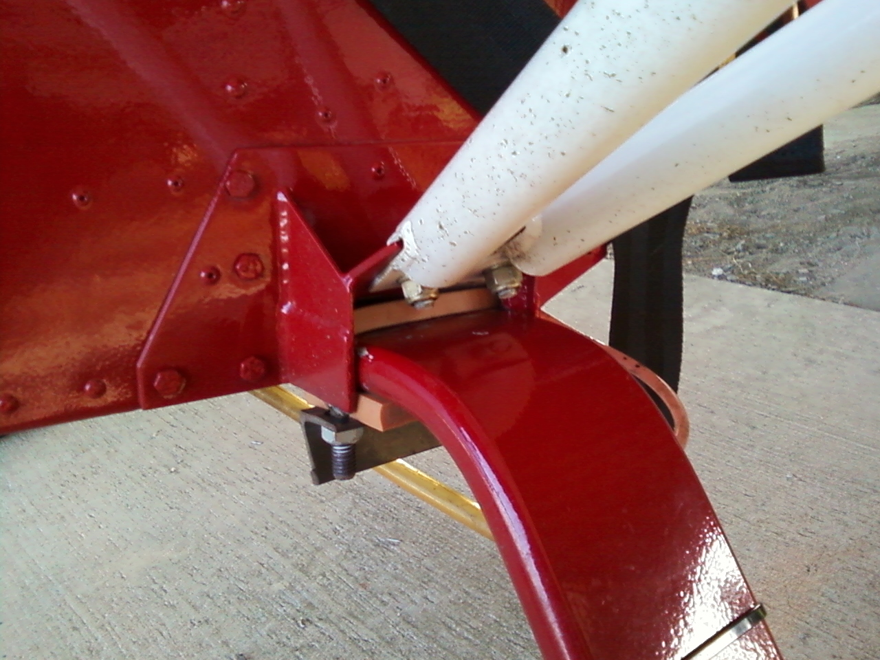

    Hello all, On Saturday, I was able to replace the strut fitting along with new rubber spacers from Zenith, I flew her 220 miles home. Thus ends what is most likely the most stressful week I have had in aviation. I have included pictures... 1 picture I left out earlier as I was ashamed and tied up on a lot of other emotions. I have decided to share it. Maybe it will save someone's life. I will predict a few quetions: No, the front gear is not bent. No, the prop didn't hit. I knew the supports were broken as I heard them break as I rotated to take off from a very short private strip in Southwest Va. I could see the gear was hanging crooked. I comforted my passenger and headed to the airport. She was clueless untill I handed her a fire-extinguisher and asked she pray. When the wheels touched, they folded back. They never came out of the channel and thus the gear spring held the belly off the ground I never stopped the controlled descent until she was scooting with the gear folded back. The only thing touching the ground was the leading edge of the gear and the rudder horn. (I replaced the horn). It wore the heads of the bolts holding the rudder cables and did not put a scratch on the airplane. I keep saying that because I can't believe it. Not a scratch. I came out of this unhurt with my plane completely undamaged. I am absolutely amazed. Other than a couple of nicks on the gear, there isn't a scratch on her. I give God the glory for this one guys... not my pilotage. I want to present a few questions: 1. how do I determine the bolts are tight enough on the gear. 2. Should the gear "give" at all when braking. Mine still does... Not much.. but maybe its not tight enough. I want to thank you all for your help. You will see that I used your suggestions during the work on Saturday. By the way, if you ever get a chance, stop in to KJFZ. Those are some fine people. -------- Ernest Jessee N4931M Read this topic online here: http://forums.matronics.com/viewtopic.php?p=307972#307972 Attachments: http://forums.matronics.com//files/0807101828_176.jpg http://forums.matronics.com//files/0807101827_126.jpg http://forums.matronics.com//files/0807101246_173.jpg http://forums.matronics.com//files/img00004_20100730_1458_168.jpg

    Subject: Re: Main gear spacer failure -- a happy ending
    Hi Jesse; Nice job on the repair. You are one lucky guy. To give an opinion on your questions. I looked at the picture showing the urethane blocks - I torqued the clamp nuts to 90 in. lb. on my plane, this compressed the blocks a little. I would tighten the A3 bolts to the top limit of torque for that size of bolt to allow for the drag of the nylon lock - 25 in. lb. FWIW if you have the drawing set and other documentation for your aircraft I think for a small charge you can get the factory support. The construction standards are an excellent source of information. do not archive Regards, John CH701 - Colorado - Jabiru 3300 Cell: 719-494-4567 Home: 303-648-3261
