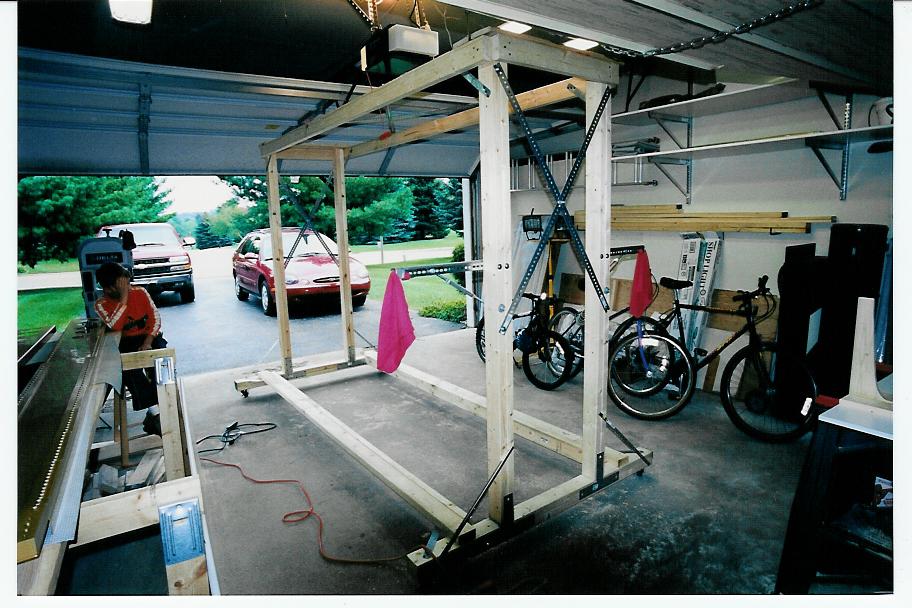

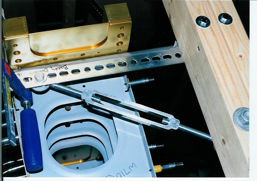

Subject: Wing jig Description: Picture 1 shows the jig and how it is constructed to build both wings at the same time. The jig is on wheels so it can be moved around the work area and the center section of the jig allows enough room for someone to work on the inside of the wings. Picture 2 shows the how the supports can be adjusted to ensure the main spar sets level. These support adjustments are on both ends.
