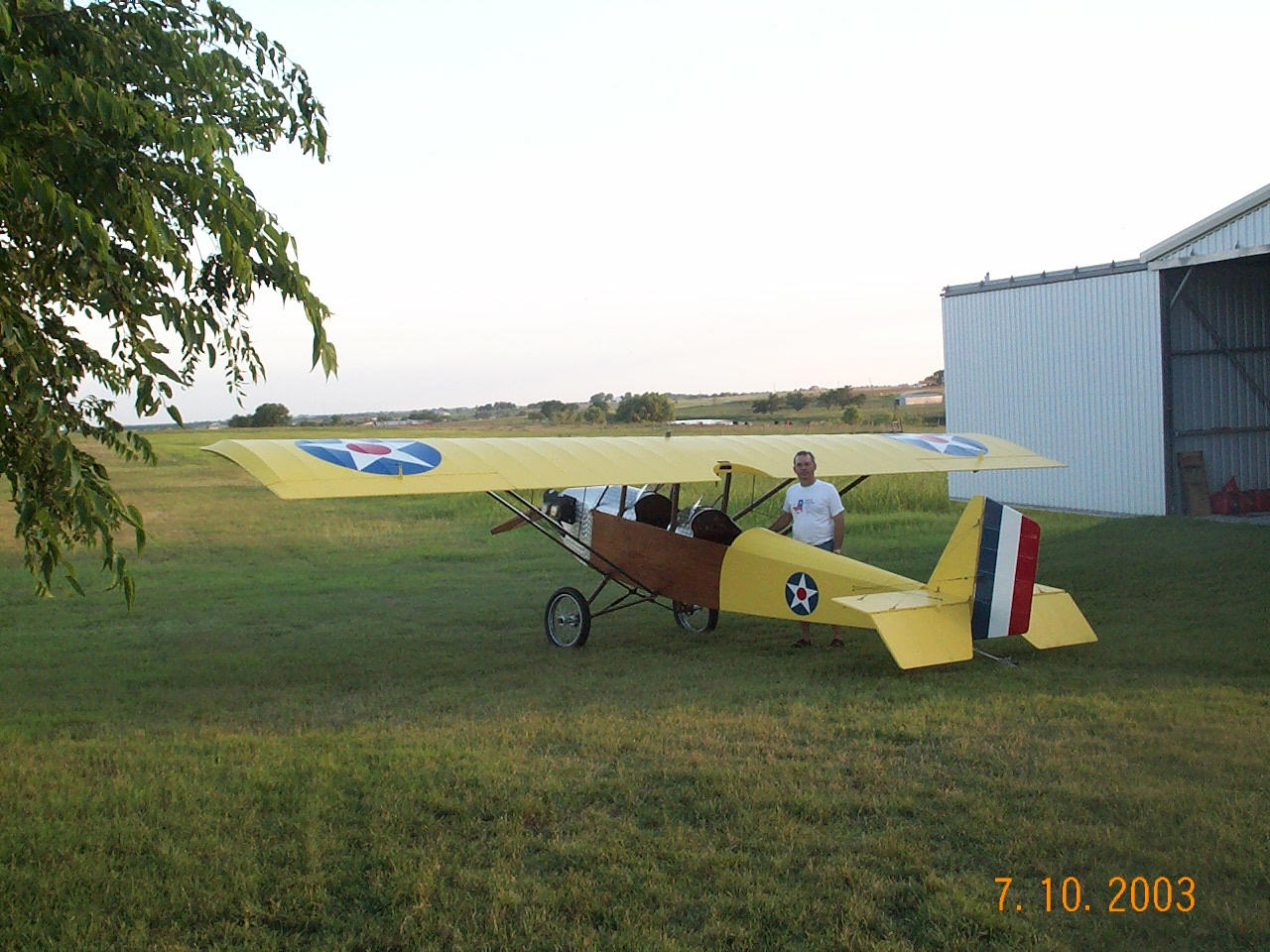

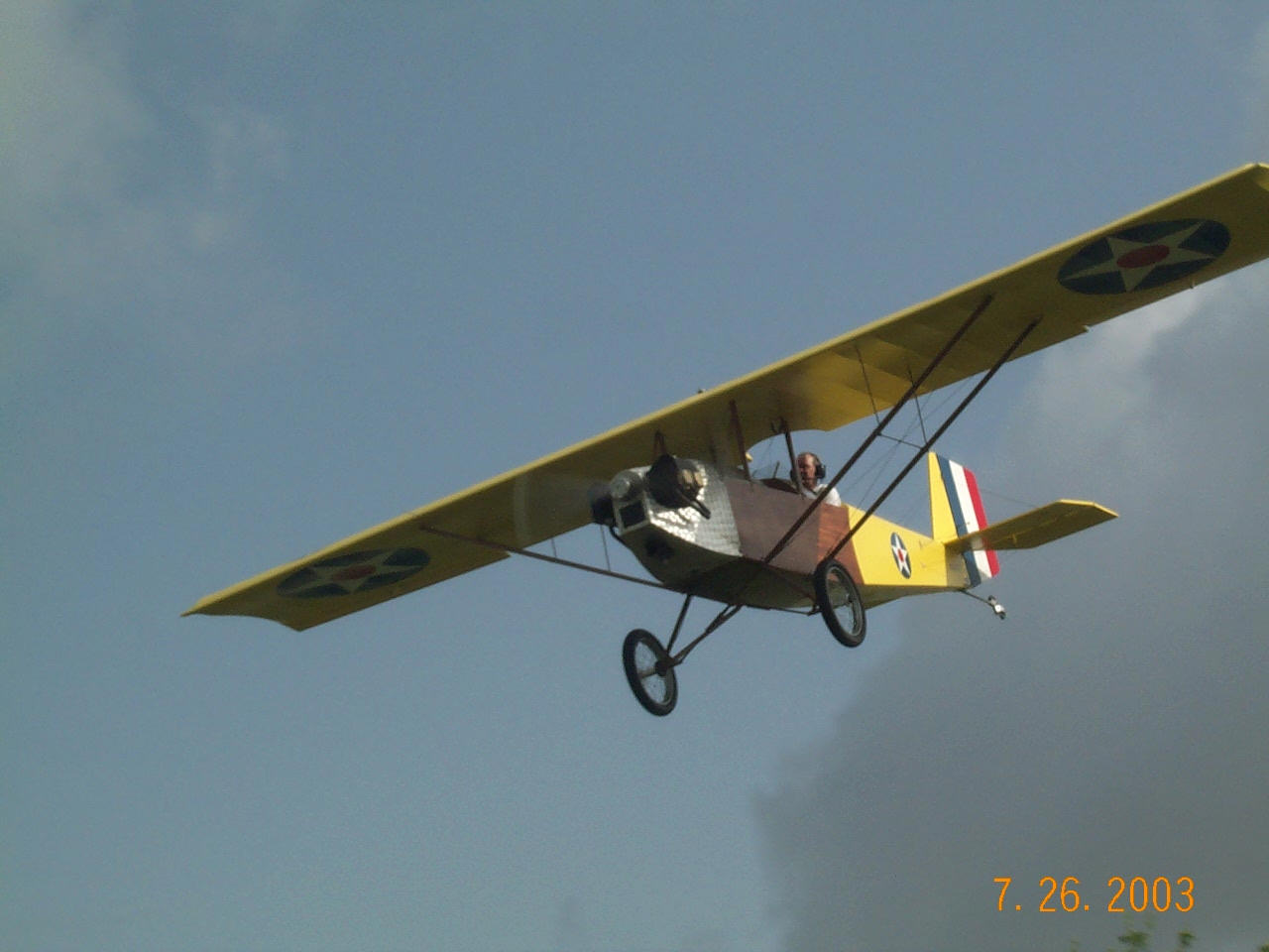

Subject: First Flight of N23TX Description: N23TX is powered by an A-65 and has a one-piece wing with laminated wood spars. Honda 18wheels and go-cart band brakes. It has an aluminum riveted center section gas tank that holds 12 gallons (built like an RV tank) Aluminum tailspring off of an S-1 Pitts with a locking tailwheel. No radio, no starter, no nothing! Weighs in at 592 lbs.
DCP_1005.jpg Photo on the Ground DCP_1016.jpg Photo in the Air!
