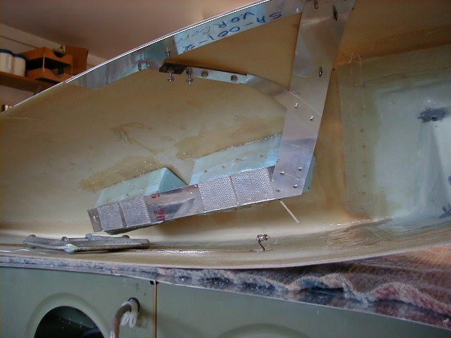

Subject: Archer Wingtip Antenna in RV-8 Description: I installed the antenna as directed but glassed a foam block at the top and cut the top of the blocks at an angle to rest the blade on and glassed it in place. This added a vertical component to the antenna. I also installed the marker beacon in the same tip by mistake so left it there. Have transmitted with both on and nothing odd happened on the beacon panel. Not flying yet though. I think Ed Holyoke's installation is a little cleaner in his 7.
Archer_VHF_1.jpg Installation in RV-8 wing tip. It is really a VHF not VOR antenna as marked on blade.
