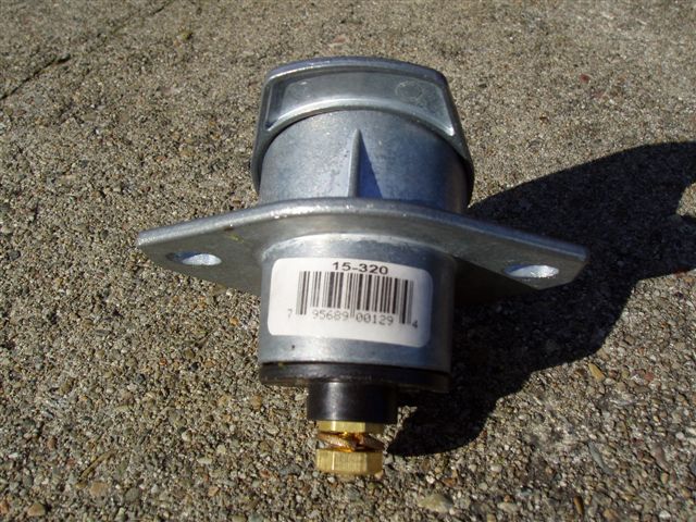

Subject: Piper Style Ground Power Socket with bolted center connector Description: The "Piper Style" socket is an SAE J560 socket.
In addition to the Cole Hersee model that you have to modify or solder, there are some by other manufacturers as well.
I found this Phillips J560 at a Peterbilt parts counter for about $11. It has a nice brass bolt on the back. No modification or soldering required.
Tramec.com also has the 38181 at http://www.tramec.com/products/page32.html
And you may be able to get it with a Nylon face as well. http://www.tramec.com/products/large_recep.pdf
This may be easier than modifying the Cole-Hersee socket.
Phillips_J560_Socket_with_bolted_center_conductor_.jpg Piper Style J560 power socket from Phillips with bolted center conductor
