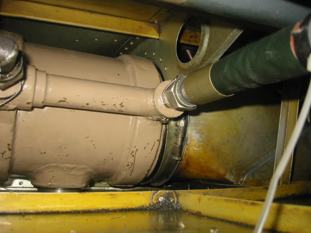

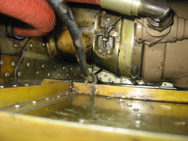

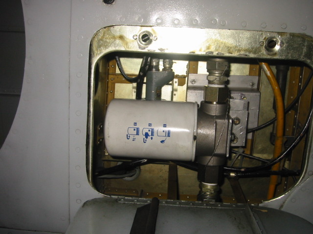

Subject: Oil Filter placement - CJ6A Description: 10 micron oil filter location near the oil cooler. Easier to keep the plane clean, easier to install, allows for easy return to original configuration. Photos show placement of oil filter and oil line runs. Need to make bracket and one oil line.
FILTER1880.jpg Shows location of oil filter directly behind access panel in front of fuel tank. FILTER1884.jpg Shows fabricated oil line with 90 degree fitting on oil filter and straight fitting on oil cooler. FILTER1885.jpg Shows 90 degree bend of original input oil line that previously went to oil cooler input.
