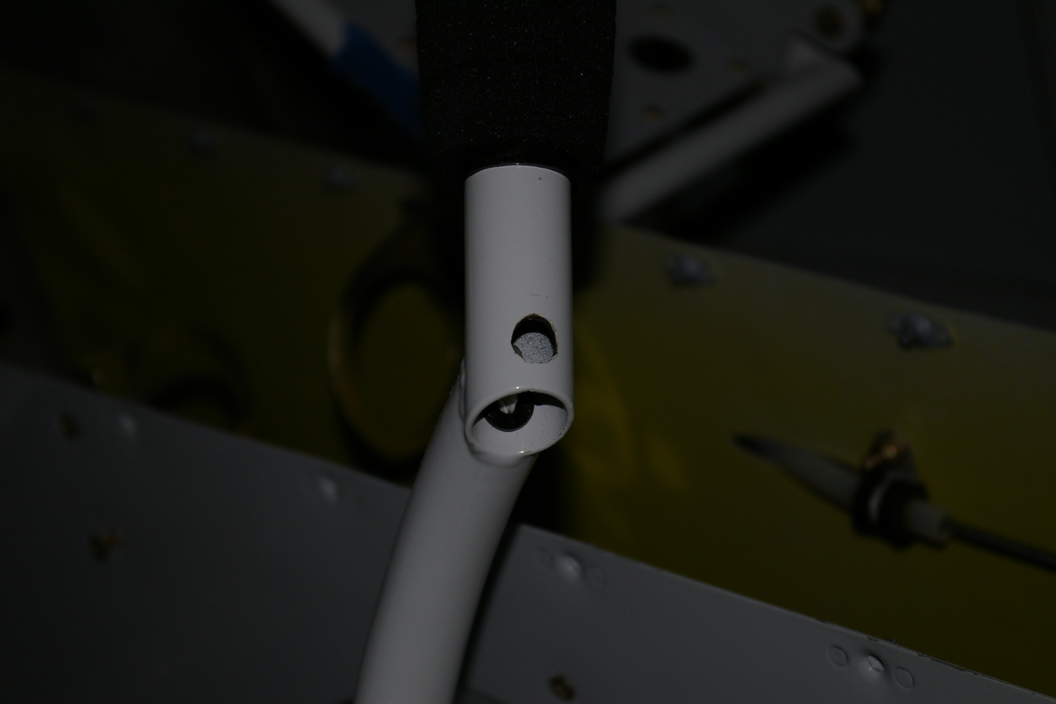

Subject: RV-10 control stick mod Description: Originally from Rob K. "I drilled a hole on the vertical shaft and into the half-moon part of the stick. I then routed the wires through the hole and into the stick and pushed them up the vertical portion of the stick. I have a hole facing me as I fly in the vertical part of the stick that has no purpose. This is the only way I could think of to conceal the wires."
Control_Stick_Wire_Route.jpg RV-10 control stick modification for wire routing
