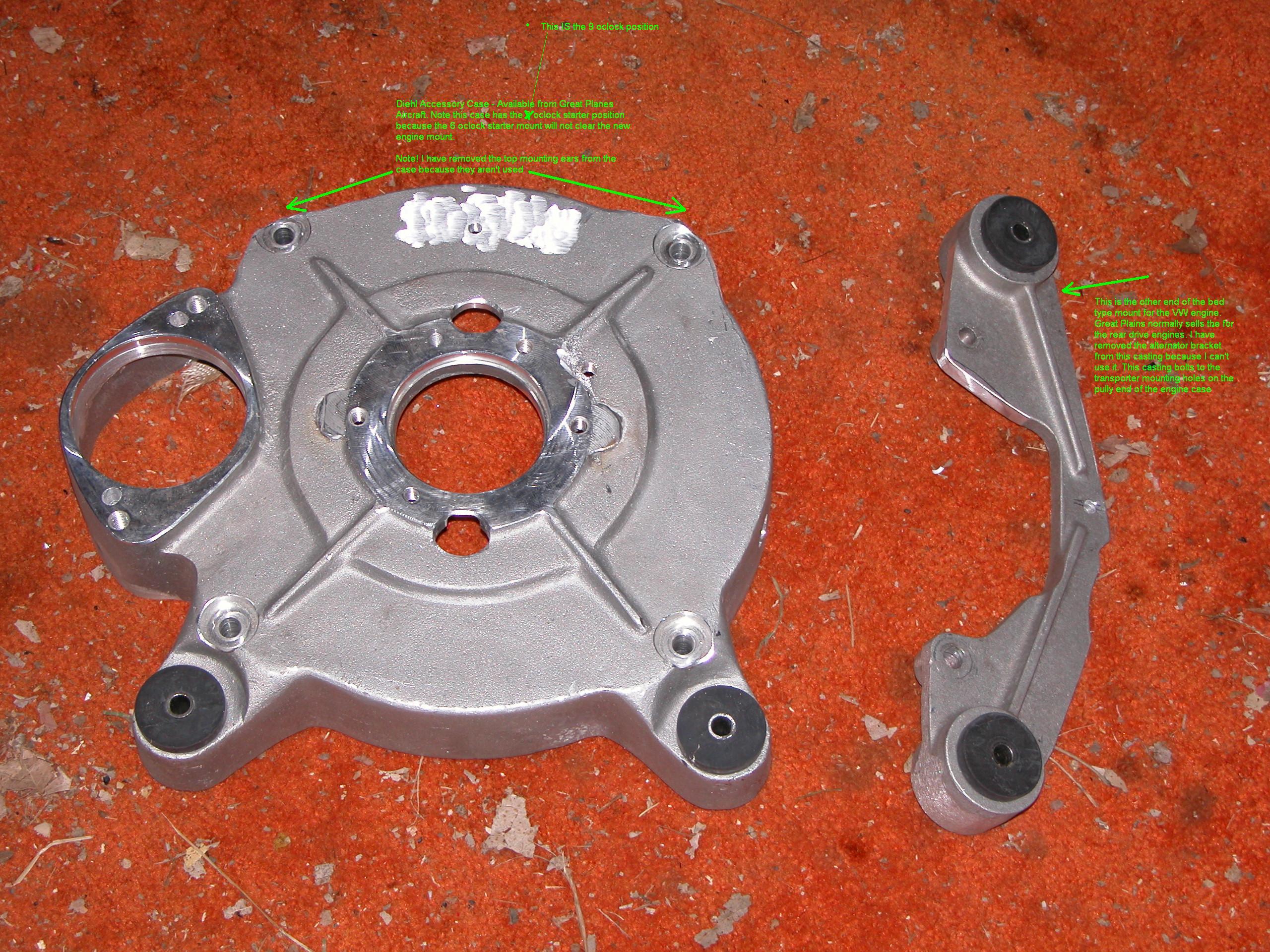

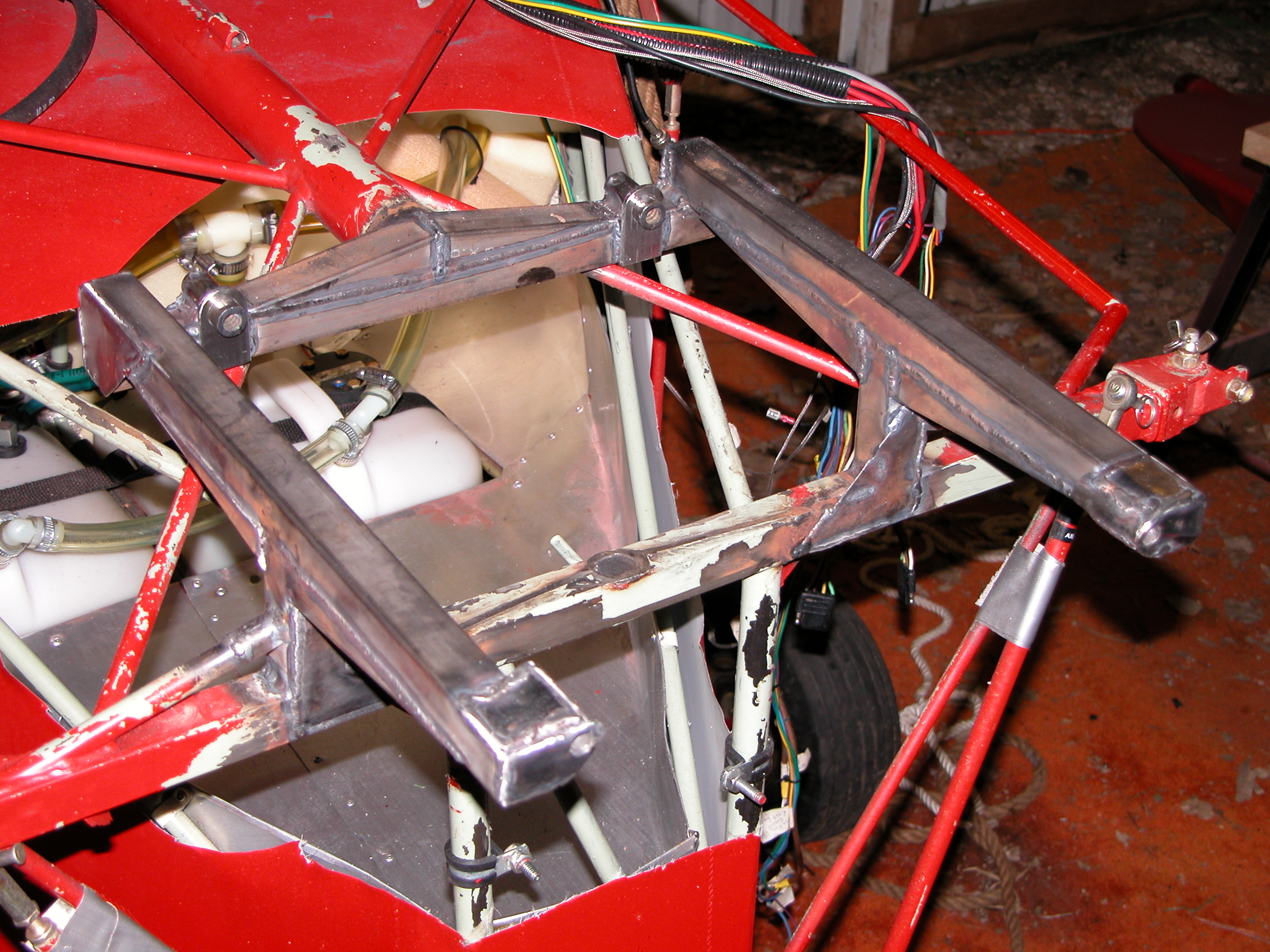

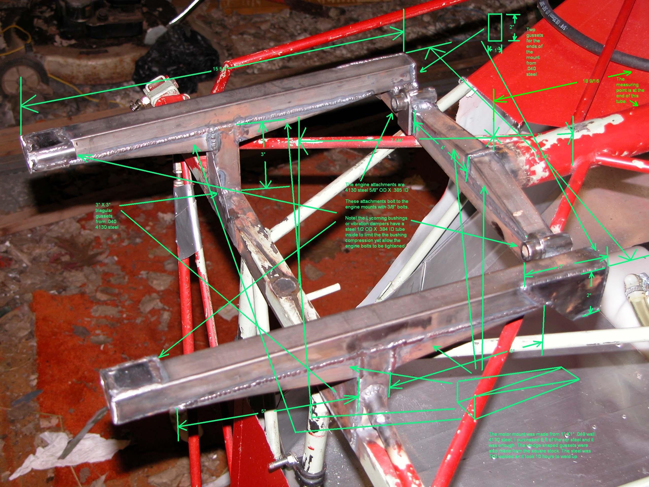

The attached photos show the new lowered motor mount on a Kolb MKIIIc. The new mount has a 2 3/8" clearance between the 72" prop and the boom tube down from over 7" with the old mount. I cut the Kolb engine mount off the cage and welded the new mount on. The new mount should be close to 5 lbs lighter than the old mount with the VW to Kolb adapter.
    DSCN2943.jpg This shows the VW engine attachment points for the bed mount.
    DSCN2946.jpg The new VW bed type mount.

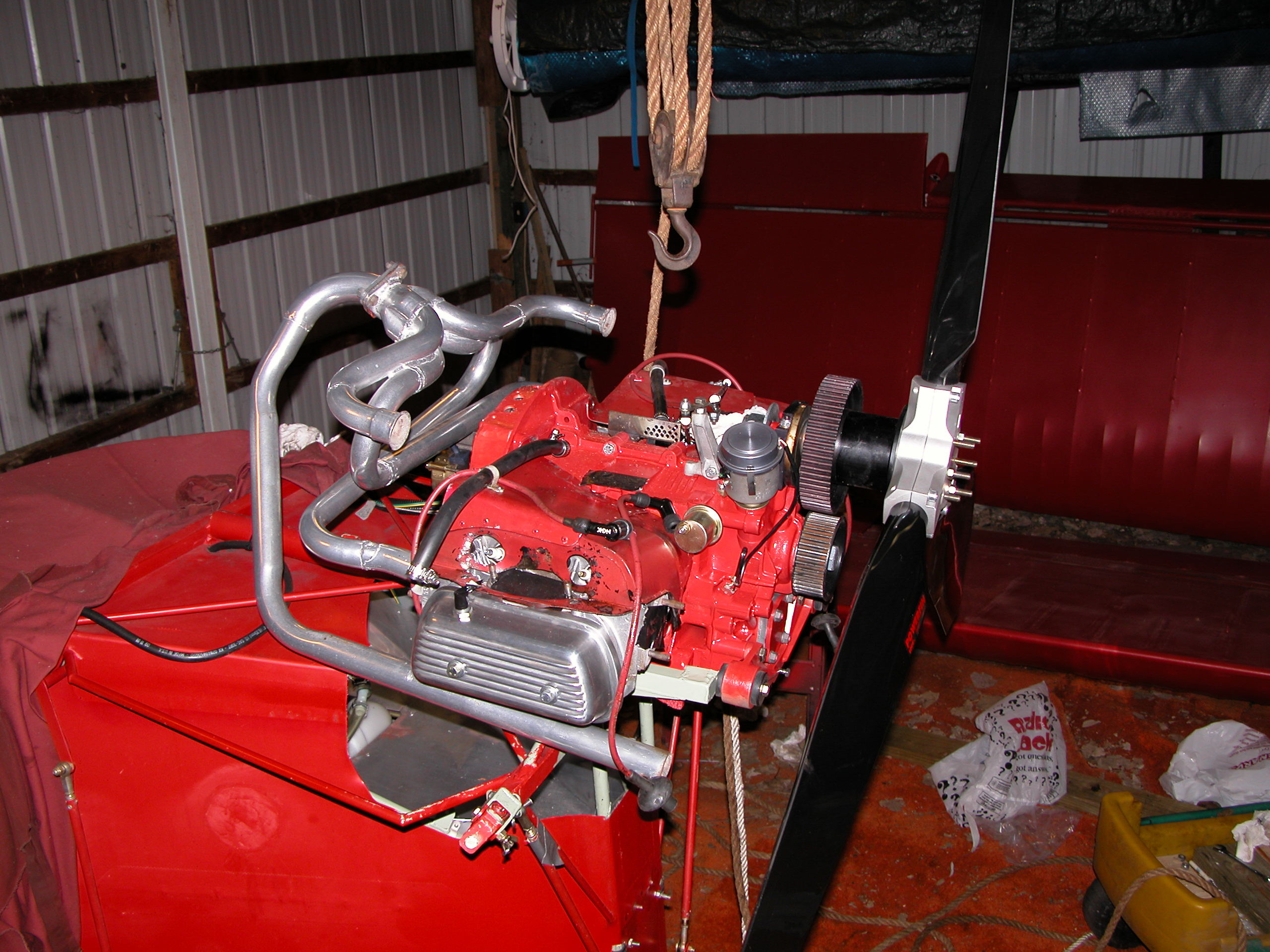

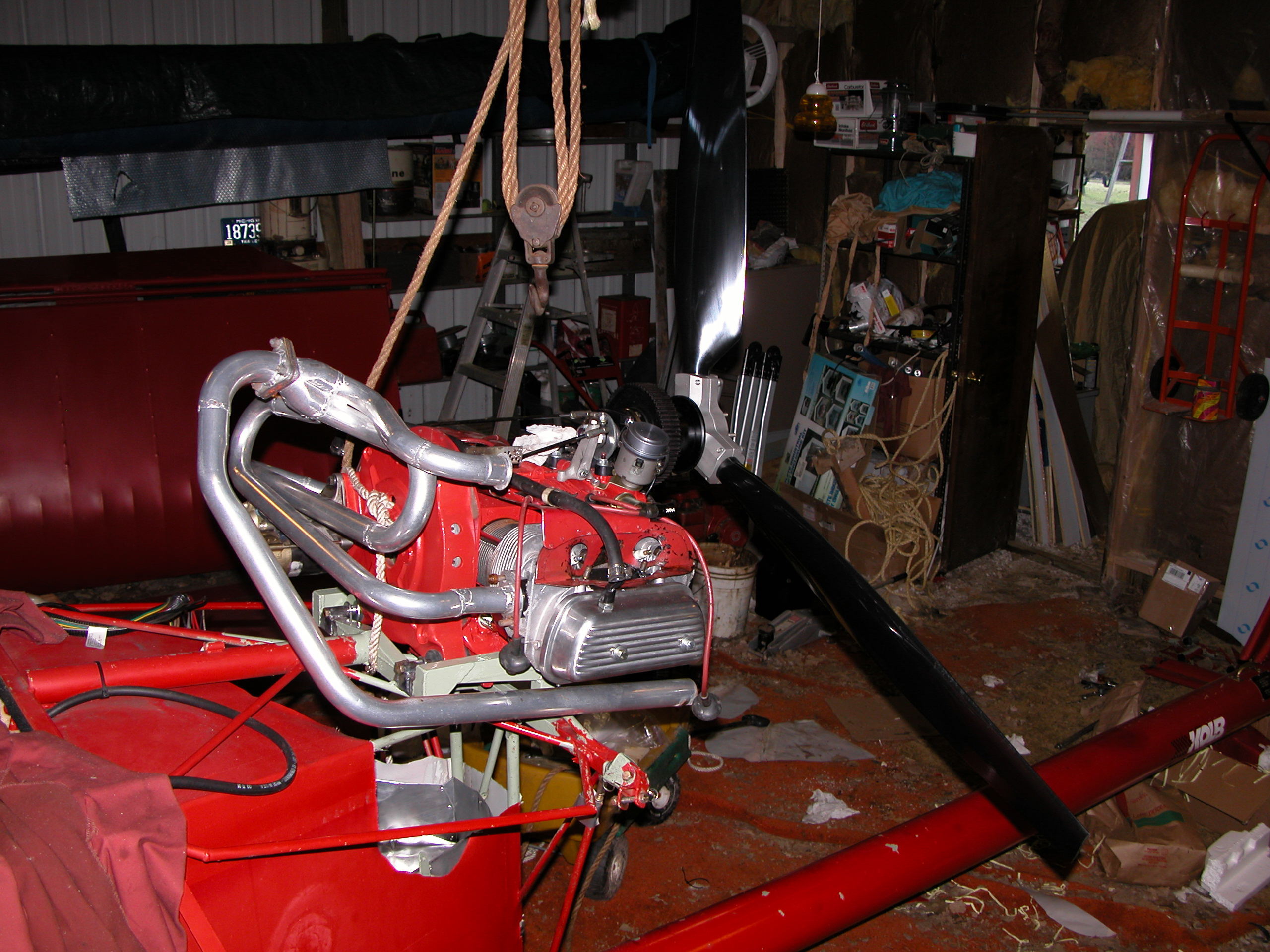

    DSCN2947.jpg 1st Test mounting of the new engine and beefed up redrive bracket.
    DSCN2948.jpg Another view mounted VW. Everything fits.
    VWMotorMount.jpg VWMotorMount - Zoom in there is a lot of detail described in this photo.
