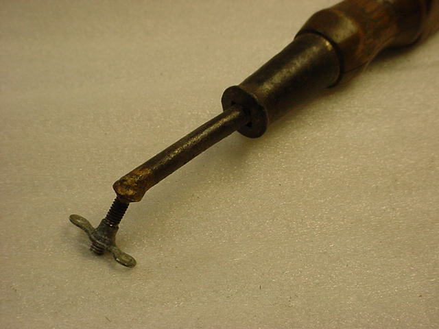

Subject: Permanent Plate-nut Drill Jig Description: This is a cheap screwdriver with the appropiate size screw brazed/welded to the end.
MVC-002S.jpg When the holes in the plate-nut start to get sloppy,rivet it on somewhere and put a new one on the jig.
