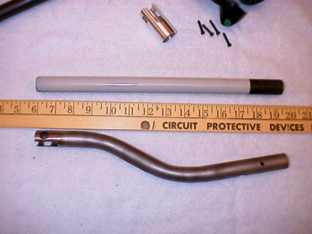

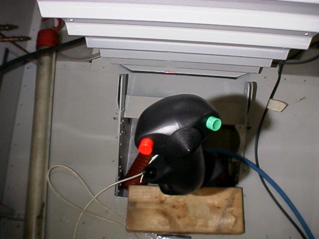

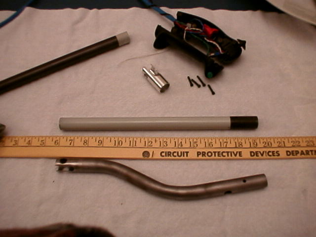

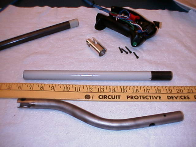

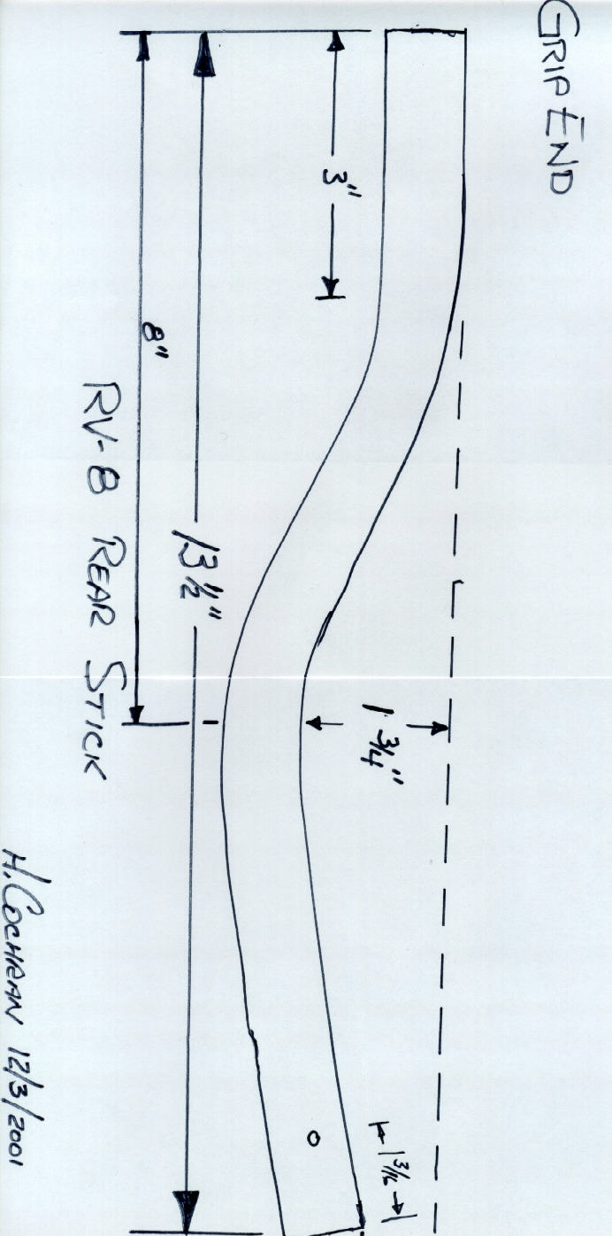

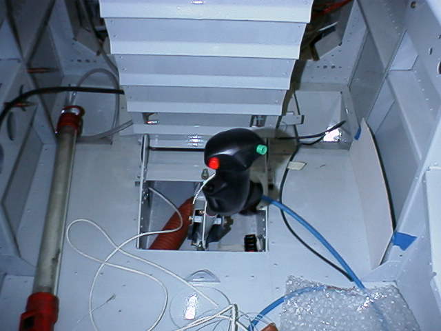

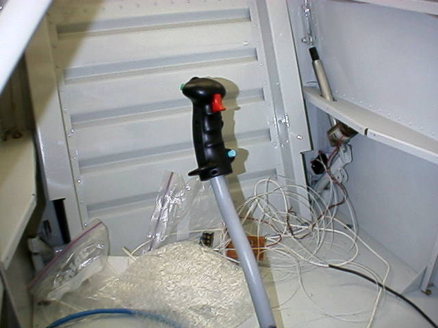

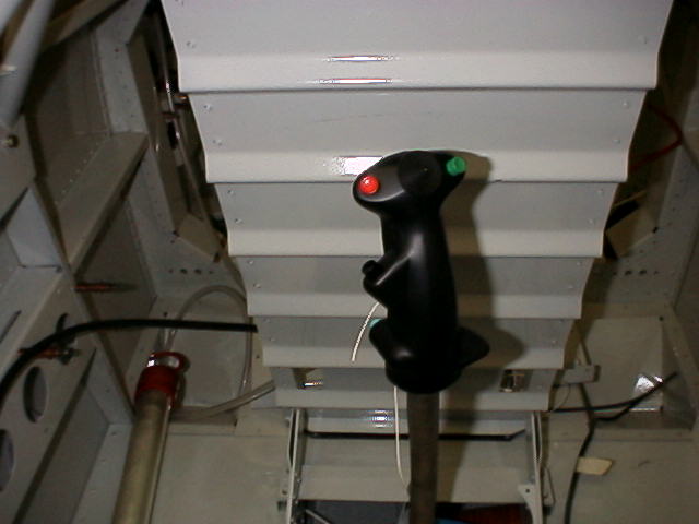

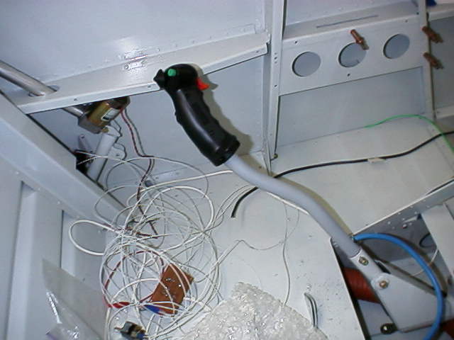

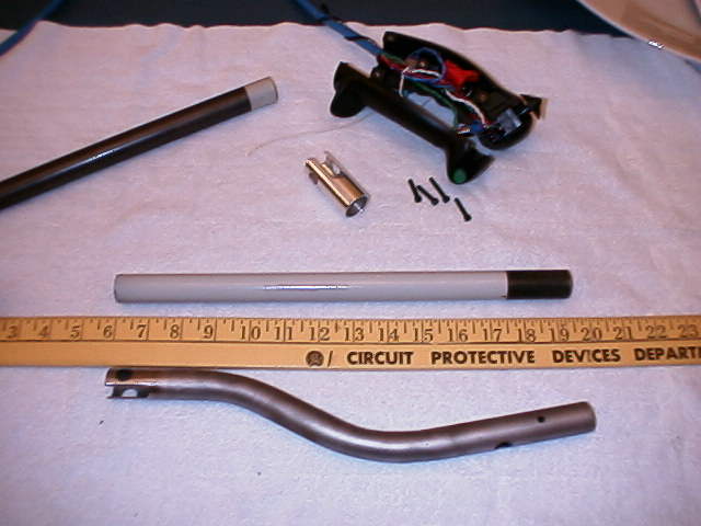

Subject: RV-8 Rear Stick w/ "S" Bend Description: Several people have requested copies of the following pictures one of which is an outline that can be used as a template for bening the rear stick in and RV-8 to accomodate the Infinity Stick Grip. Without the bend, the grip will hit the back of the pilots seat before you reach the full down elevator stop.
rearstick_dwg.jpg Drawing rv8rs10.jpg Stick Detail rv8rs1.jpg Control Yoke rv8rs2.jpg Stick rv8rs3.jpg Stick rv8rs4.jpg Stock vs. Bent rv8rs5.jpg Stock vs. Bent rv8rs6.jpg Stock vs. Bent rv8rs7.jpg Stock vs. Bent rv8rs8.jpg Overview of Installation
