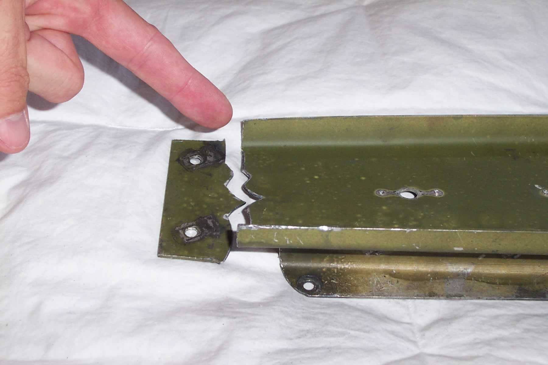

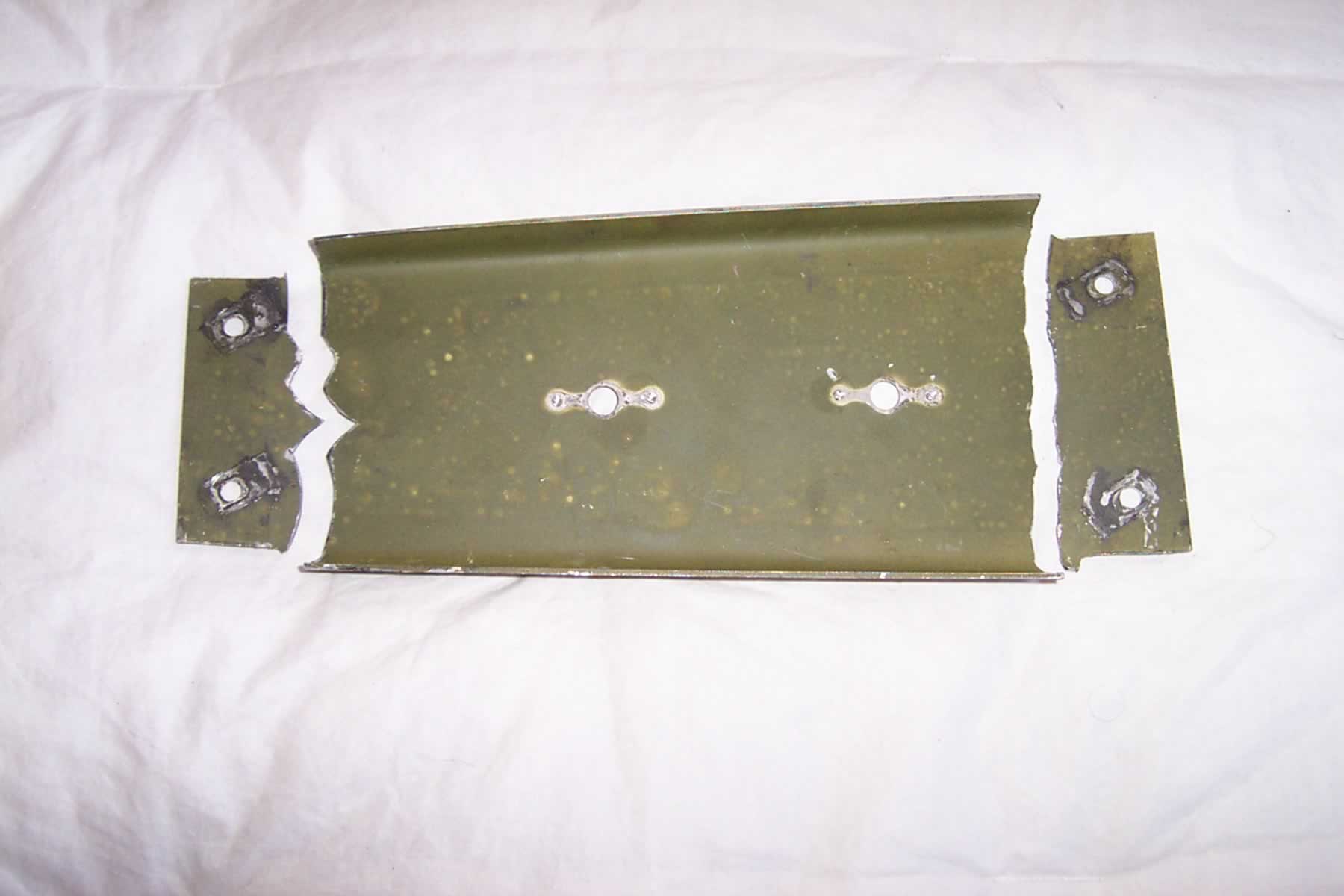

Subject: Tray failure and Inspection Description: The tray holding lead plates broke under G. Please inspect for cracks, warping. Not the lack of the curve running the entire length of this example. The mounting "tabs" on either end could not support the load.
tray1.jpg Photo 1 Tray2.jpg Photo 2
