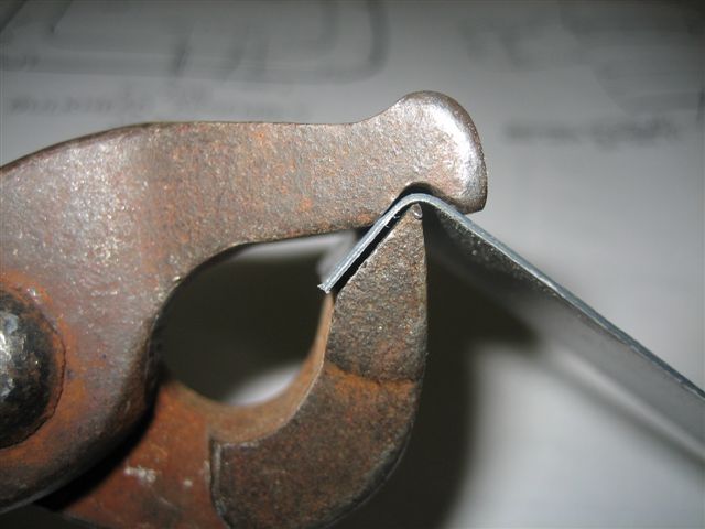

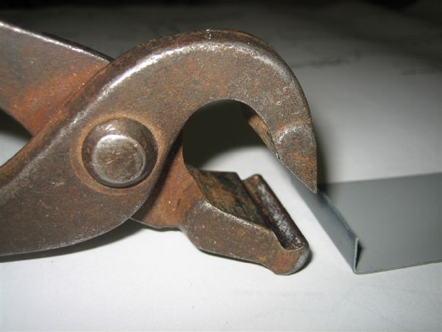

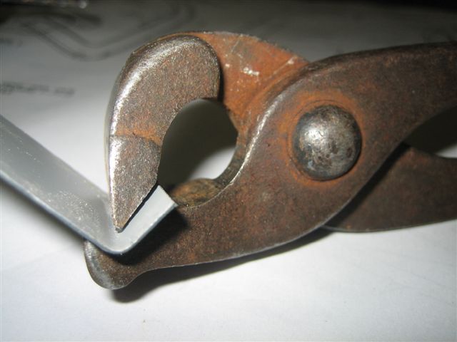

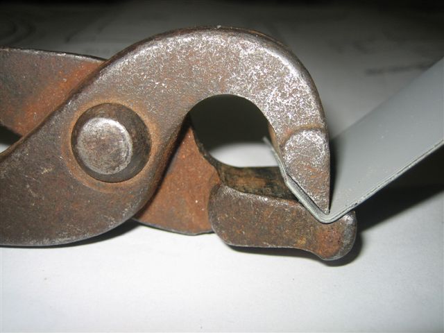

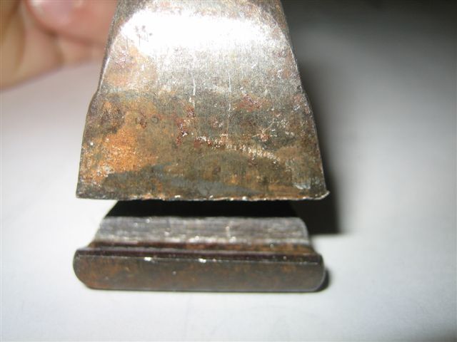

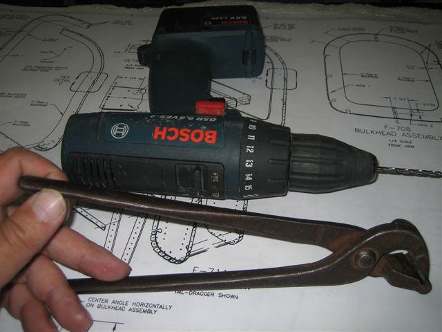

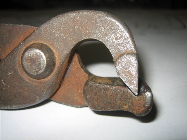

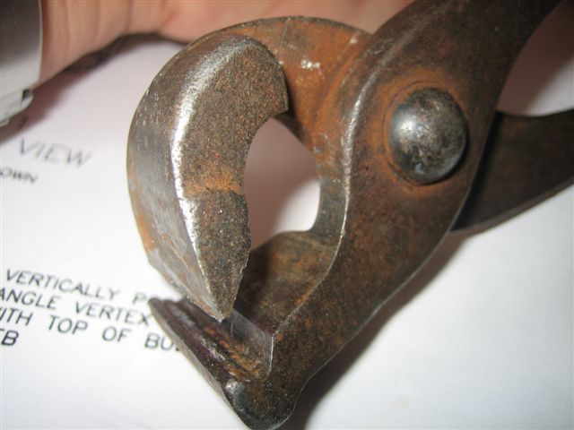

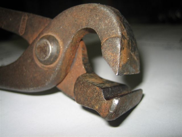

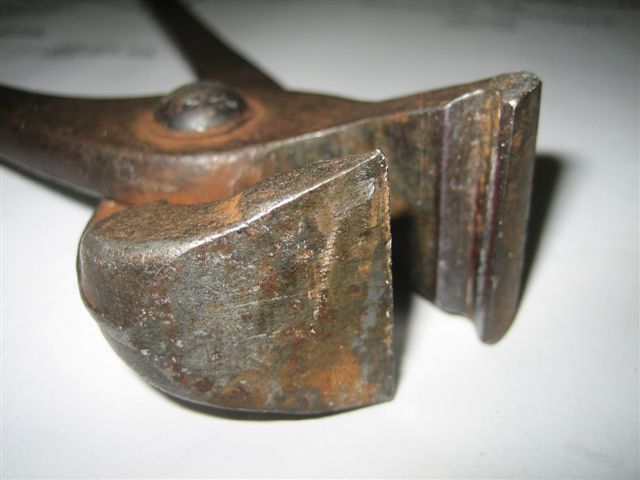

Here's a GREAT tool! It's kind of a pliers which makes PERFECT 90 degree bends on soft metal, for example the metal a RV is made of. This one is found a tinsmith (tinman) shop and it's an old tool. With this tool, you'll make the PERFECT trimtab in less that FIVE MINUTES! The bend will be EXACTLY where you want it to be, and with perfect bend-radius! The bend on the scrap metal in the pic, I made myself in about FIVE SECONDS!
Since it's here in Norway, it must also be possible to find with tinsmith shops in other parts of the world. It's definetely worth at try! I've also sent pics to Mr Bob Avery at Avery Tools, and maybe they'll start making it?
The pics are in low resolution to save space, but if you like them in high res, please contact me and I'll be happy to send them to you.
