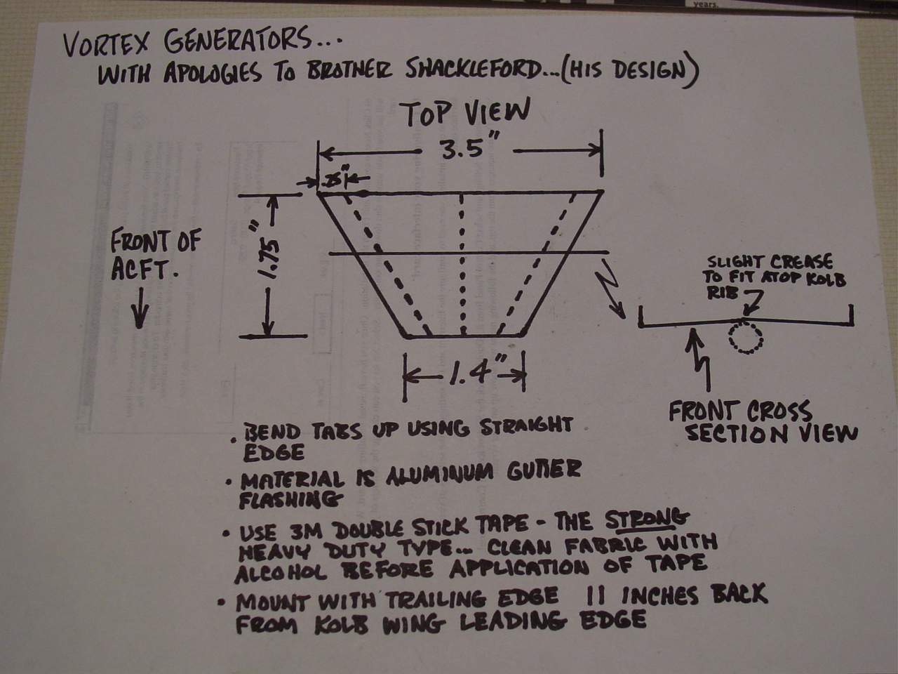

Per several requests, attached here is a photo of the crude drawing I cobbled up of the VG design as installed on the Kleenex Firefly.
This is Howard Shackleford's original design I believe... and I think John Jung made the original drawings of it for the Kolb list... (which I could not find)...My apologies to both of you gentlemen for my humble efforts to replicate your fine original work.
Anyway, the Kolb archives have a ton of stuff on VG's... anyone interested should look there...
