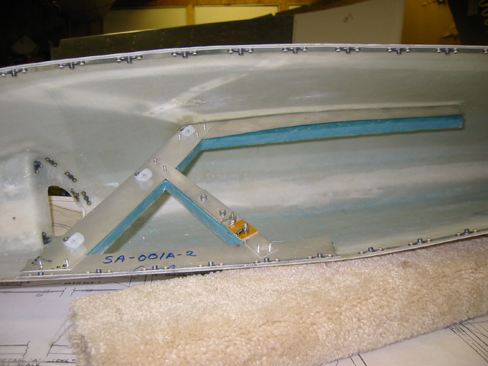

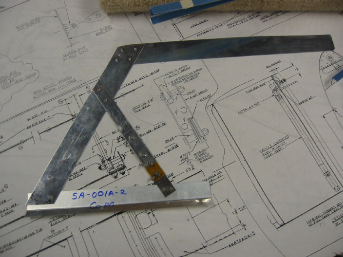

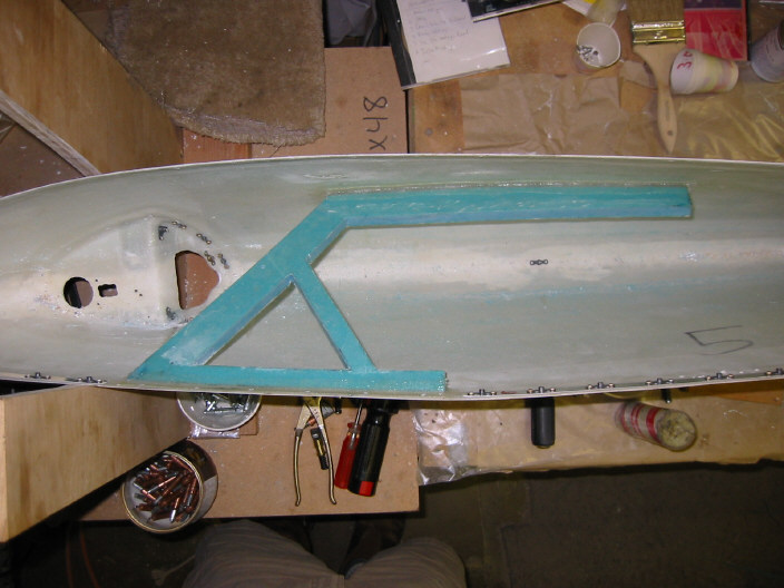

Subject: Archer com antenna in new style wingtip Description: I glassed in a piece of foam to support the antenna. I gave it as much vertical component as possible. Not yet flying so I can't tell you how well it will perform.
103-0357_IMG.jpg Foam glassed into wingtip 103-0359_IMG.jpg I bent the lower edge of the antenna to match the angle of the wingtip where it attaches to the wing. 103-0360_IMG.jpg Antenna attached to wingtip with nutplates. I later put a few strips of glass over the antenna to make sure it stays put.
