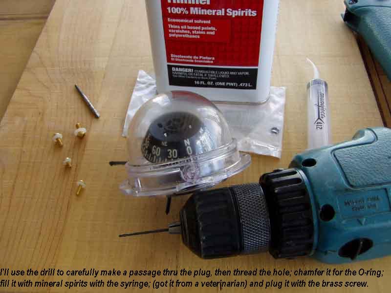

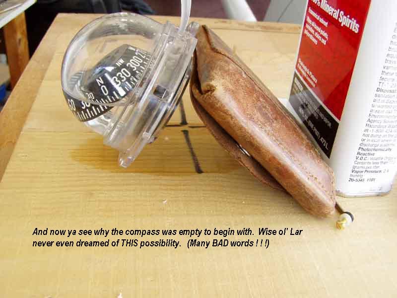

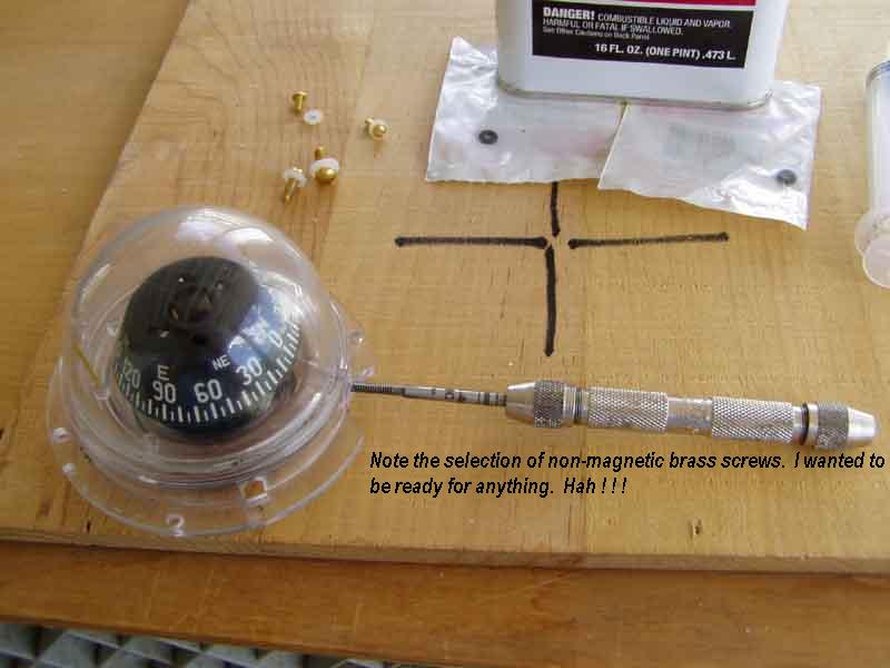

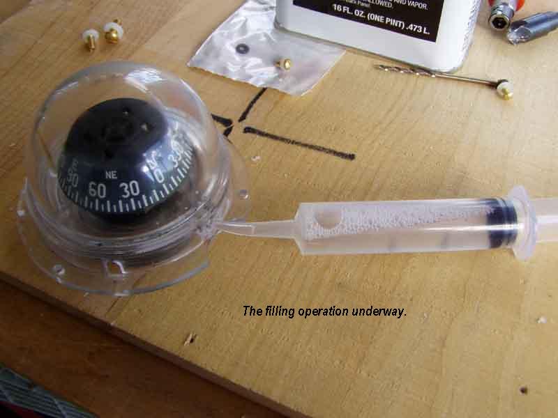

Subject: Filling a Compass Description: After all the advice on the List the other week, I went with recommendations and started to fill my compass (this is my boat compass - not Vamoose') with mineral spirits. Thanks, John ! ! ! Unfortunately, all did not go as planned...
