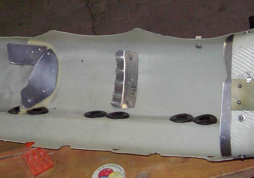

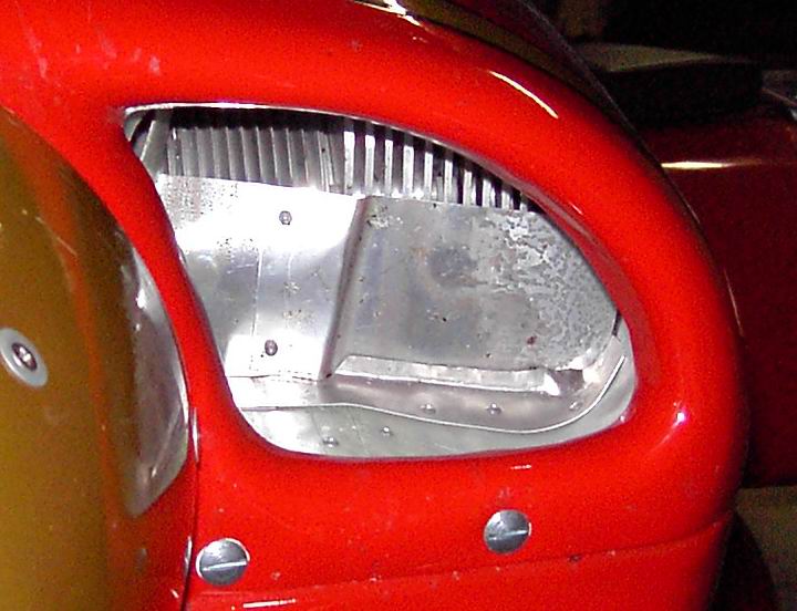

4) Smaller deflectors angled down between the spark plugs of #3 & #4. These middle cylinder deflectors usually need some tuning. Would suggest starting with 3/4" tall. On #3, I stayed at 3/4", on #4 ended up trimming down to 1/2".
5) The inlet to the ram air ducts has a gap between the duct and the cylinders at the bottom. This allows air to escape downward without doing any useful work. I added some .025" aluminum plates that butt up against cylinder's #1 & #2 to prevent this from happening. To reduce the over cooling of the front two cylinders and force more air upward to the rear cylinders, I angled the material upward about an 2-3¡¨. The exact height needs to be determined by trial end error. The new XL cowl has openings that are quite small and located high on the cylinders. My modification attempts to duplicate the XL cowl openings and seems to work quite well. At the onset, this change appears to be counter-intuitive. Just keep it mind, the goal is to get as much use out of every air molecule as possible!

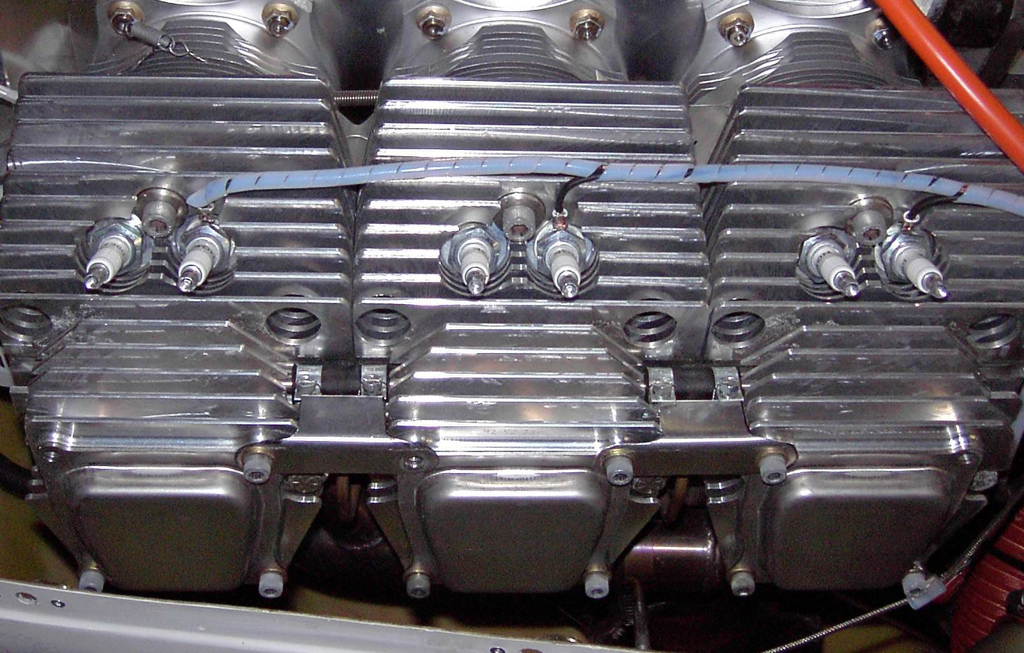

6) Small baffles mounted between valve tappet covers. This prevents more air from escaping without doing any useful work.

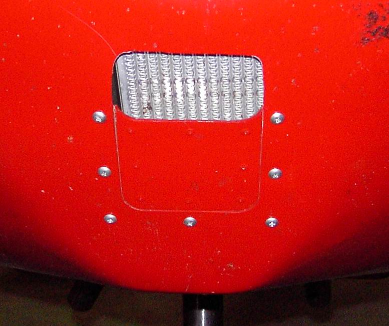

8) The oil cooler inlet is keep quite small to allow more air to find it's way through the cylinders. I ended up with about a 1.75" x 4.00" opening. The Jabiru website provides a good discussion on this. I tried a much bigger opening as can be seen in the picture and it provided very little benefit.

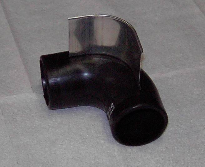

At full throttle, EGT's from left to right bank were 150 F different. I suspected that air entering the carb through the 90 degree intake elbow was piling up on the outside of the curve. I installed a vertical divider in the elbow to keep left side air separated from the right side air. This worked beautifully. My EGT's are now balanced within roughly 50 F at all throttle settings including WOT. The divider was fabricated out of a piece of 6061T6 aluminum - 5.25" x 3" x .016". The upper and lower edges were rolled around a 1/16" cable to add stiffness and prevent cutting of the rubber elbow. Finished height is just slightly over 2.25 inches so it fits snuggly within the elbow. After rolling the edges, the part was bent 90 degrees to fit the elbow contour by wrapping around a 2" diameter plastic pipe. After it springs back, you end up with a 2" bend radius whichis equivalent to the center radius of the elbow. Once the part is finished, the cable can be removed (prevents a potential corrosion issue). The rubber elbow is quite pliable in the free state, so the flow divider installs quite easily. After installation, the divider is trapped pretty well in all directions.
