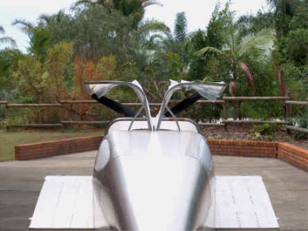

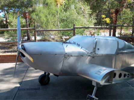

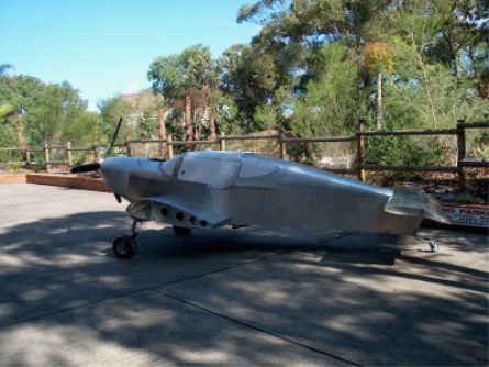

Subject: Gullwing Version Zodiac 601 Description: After finishing my first kit-built Zodiac 601 I am now building a somewhat customized version. The changes include thicker gauge sheets in the cockpit area, longer undercarriage legs, wider tires, and of course the gullwing cockpit doors. My main reason is rollover protection, plus availability of local material here in Australia. The hatch in the nose skin is for the BRS system, it lives where normaly the fuse tank would be. I plan to put two wing tanks of 45 litres each in the wing. Engine is a EA 81 with dual carbs, Amax redrive and GT 70 inch prop. Building time up to now 540 hours, hope to be in the air early April.
