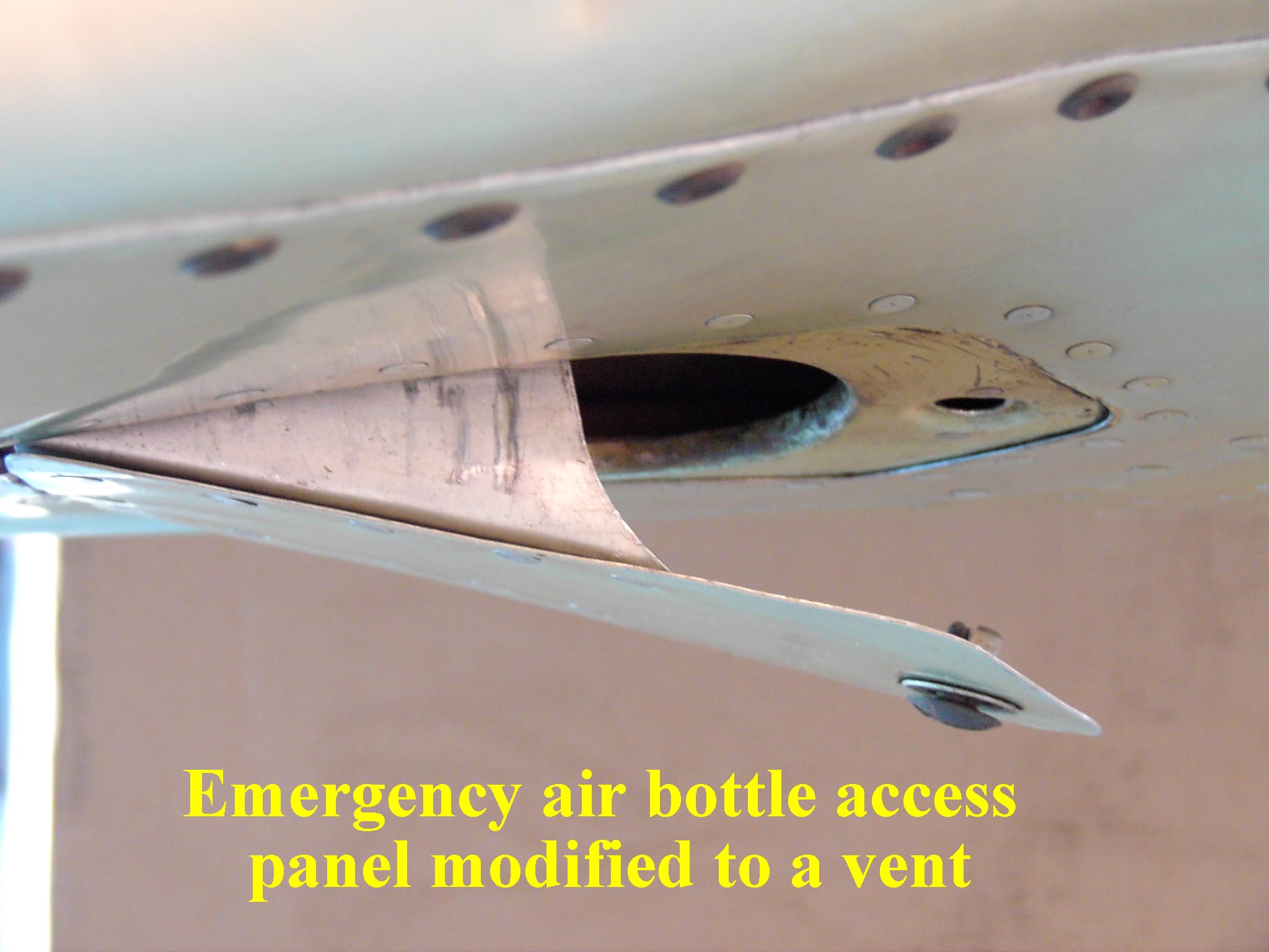

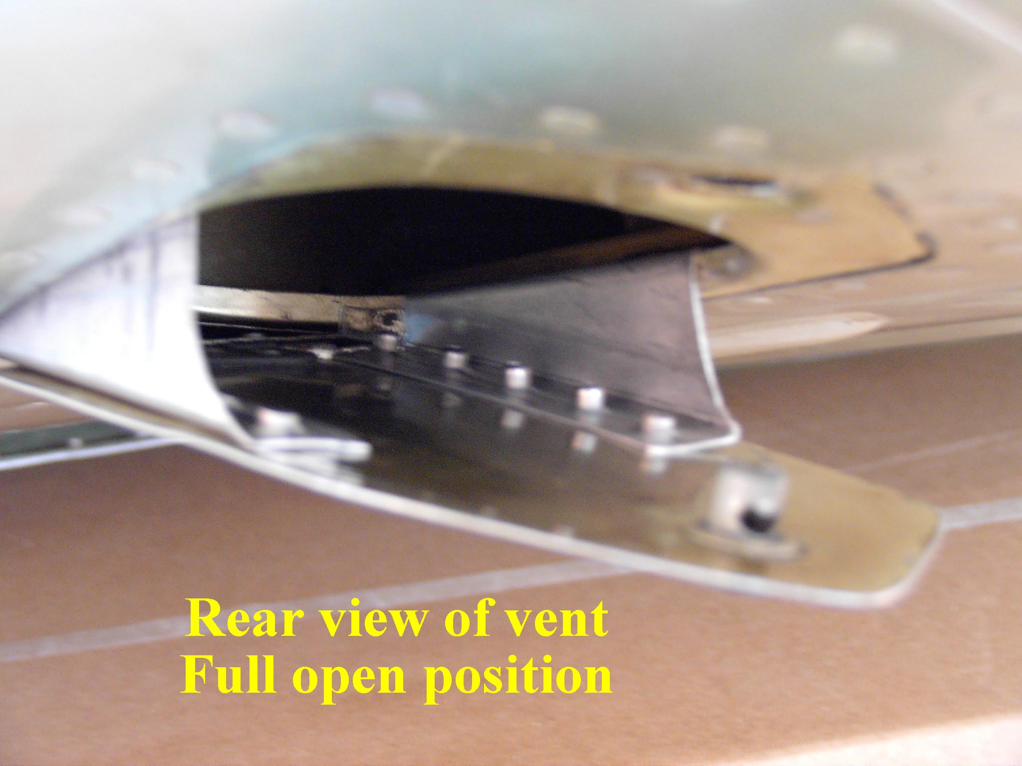

Subject: Panel to Vent Mod Description: These are pics of a mod I made to the emergency air access panel so that the lower fuselage area can be vented. This I will open when carrying a passenger. There is a positive stop limiting the down angle.
