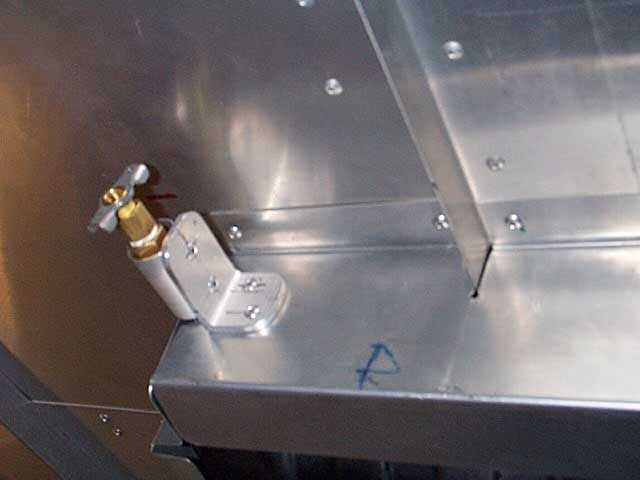

Subject: Radiator nipple solution Description: This is how I plugged the aft fitting on the radiator. It consists of a small piece of hose connected to the nipple of the radiator and a 1/4 hose barb on one end of a pipe union with the petcock on the other. I used scrap pieces to make the support just in case it wanted to vibrate around when flying and drilled a hole in the petcock handle for a safety wire.
plugged.jpg Photo 1
