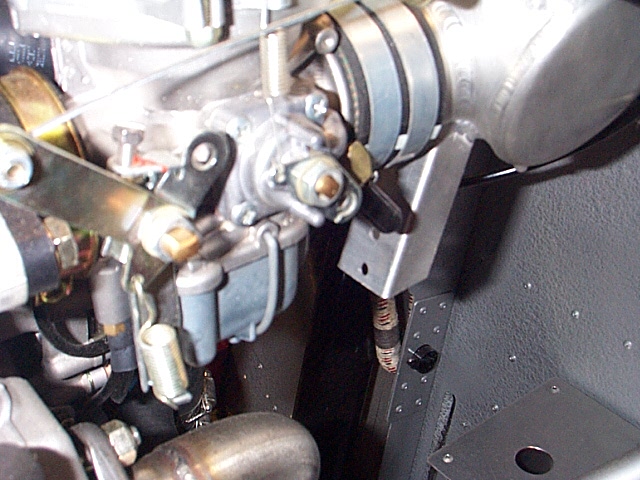

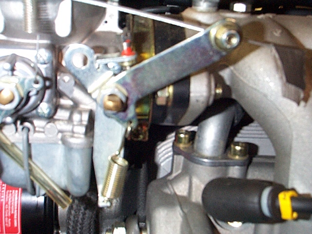

Subject: Standard Push to Accelerate Set=up Description: Bing Carbs on Rotax 912ULS Note that the throttle plate lays on the same plane as the flats on the cross shaft and is in the wide open throttle position.
