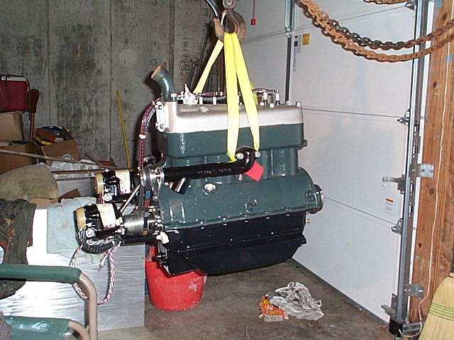

    DCP00623.jpg My Model A motor, ready for the test stand, awaiting prop and carb.

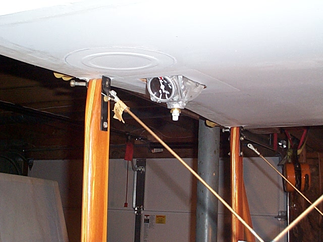

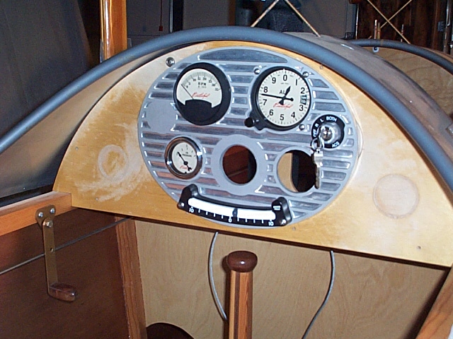

    DCP00624.jpg Instrument panel, very thirties. Special "Pietenpol" white face instruments. Electric tach runs off mag, no drive cable.

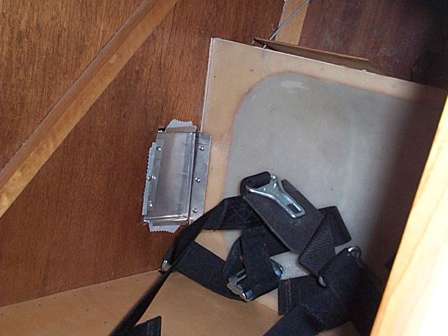

    DCP00625.jpg Front cockpit "glove box" cover. will have compass and passenger warning.

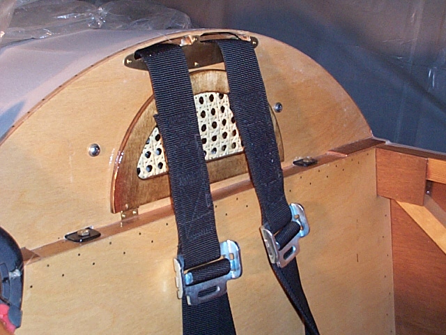

    DCP00628.jpg Shoulder harness comes out as high as i could. It is supported by a tubular structure and attached via cable to the tail skid.

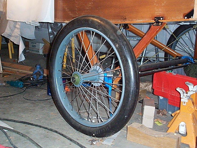

    DCP00629.jpg True old fashioned high pressure clincher tires.
