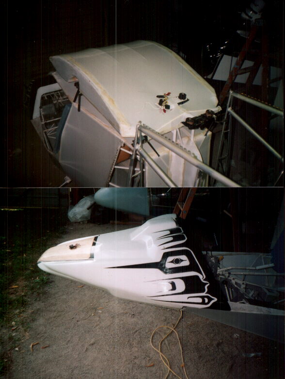

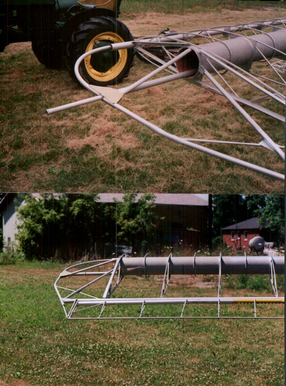

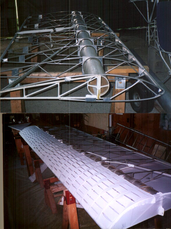

fuselage.jpg This is the pod I sculpted and a rear view of the fuselage to show the extra width at the back. My theory is that the air will remain on the side untill it leaves to go into the prop. Hopefully less drag. It also shows how the center section is shaped. wing.jpg This is how I wrapped the excess fabric around and slit it length wise to offer support to the top fabric and remove some of the scalloping between ribs. wing_tip.jpg This is the wing tip on my MkX ( modified Mk111 ). Note the retractable handle in the wing tip. I can wheel the plane around like a wheel barrow.
