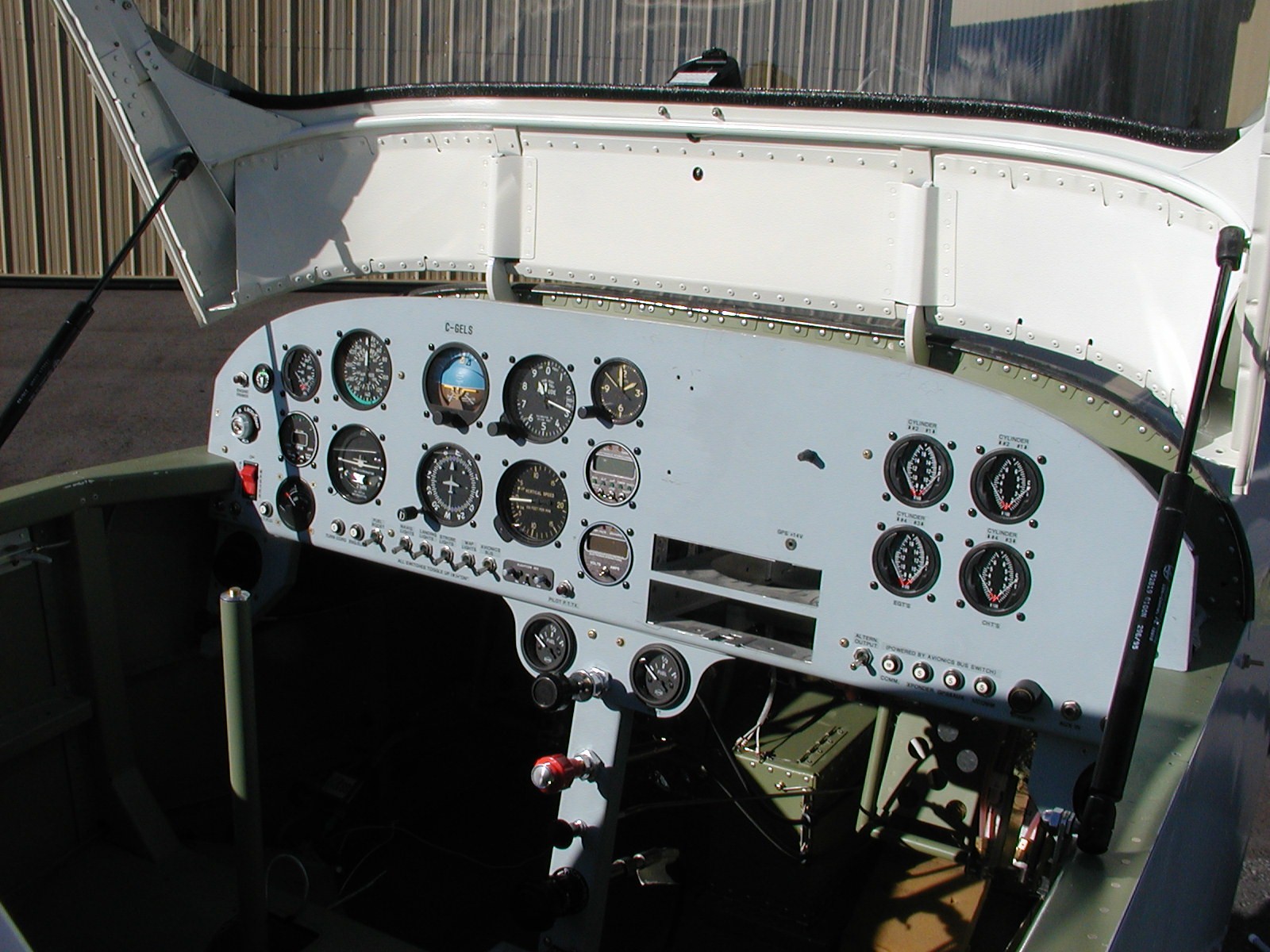

Subject: RV6-A Tip-up Canopy Stiffener Description: My solution to stiffen the canopy, done in March 1998. Secret is not to have any lightening holes and put gussets over the "J" hinges to stiffen the gaps there. Total weight: 7 oz.
pa280034.jpg Canopy Stiffener
