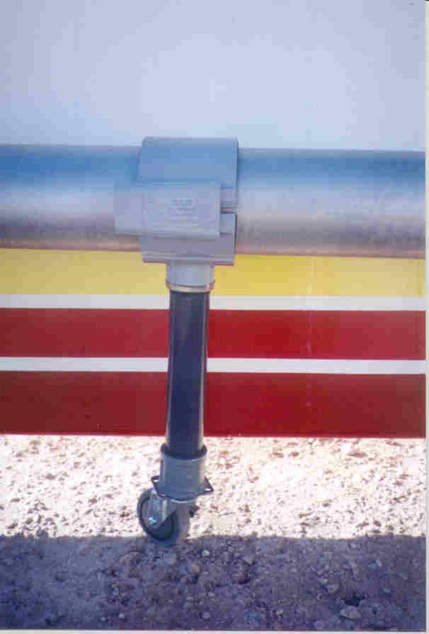

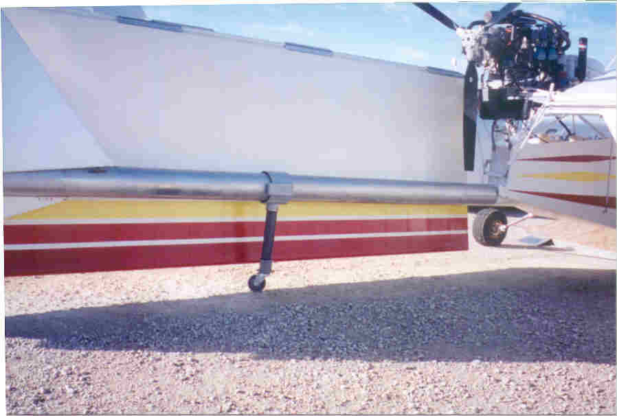

Subject: Fuselage Tube Support Saddle Description: These two photos show a fuselage tube support saddle with a wheel that I made to help me get my Mrk III in and out of my enclosed trailer. The saddle also gives me more clearance between the leading edges of the folded wings and the gravel surface where I must park the trailer. I have since modified the saddle to use an 8-inch pneumatic tire (still on a castor)that goes over the gravel easier. The saddle goes on and off easily and quickly. E-mail the list for further details.
