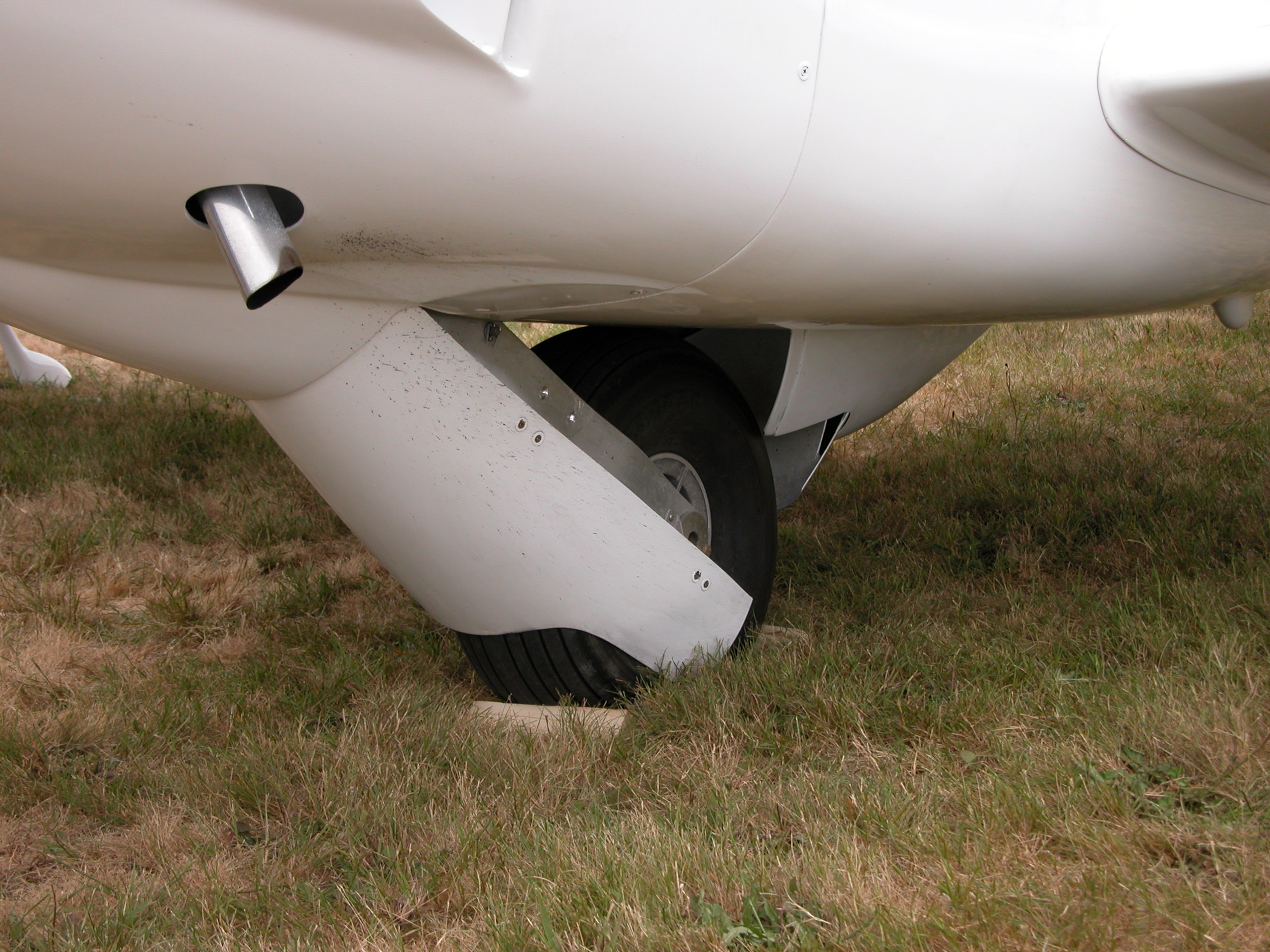

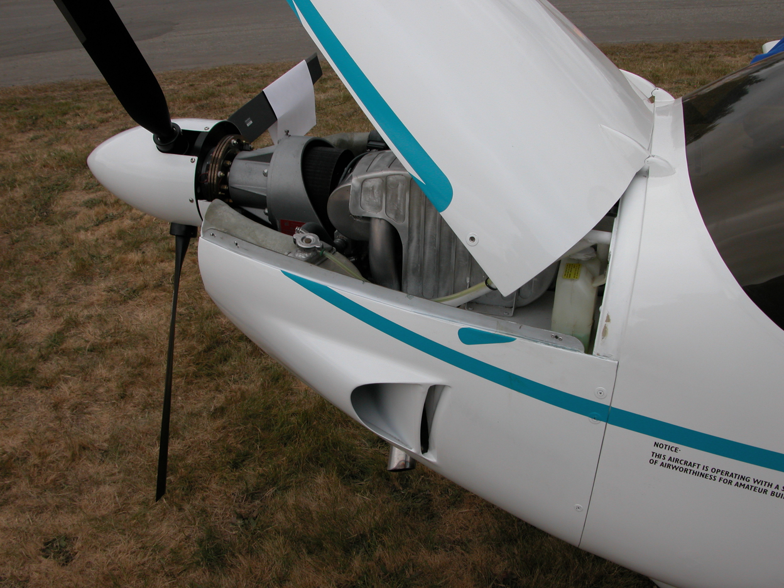

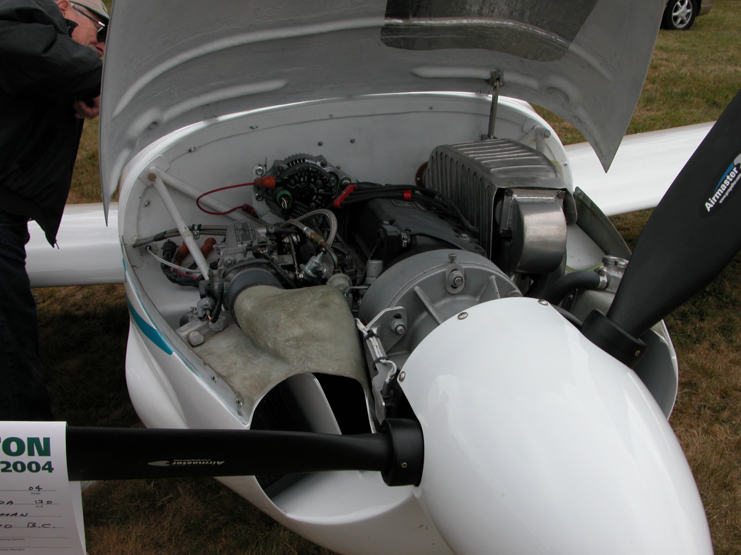

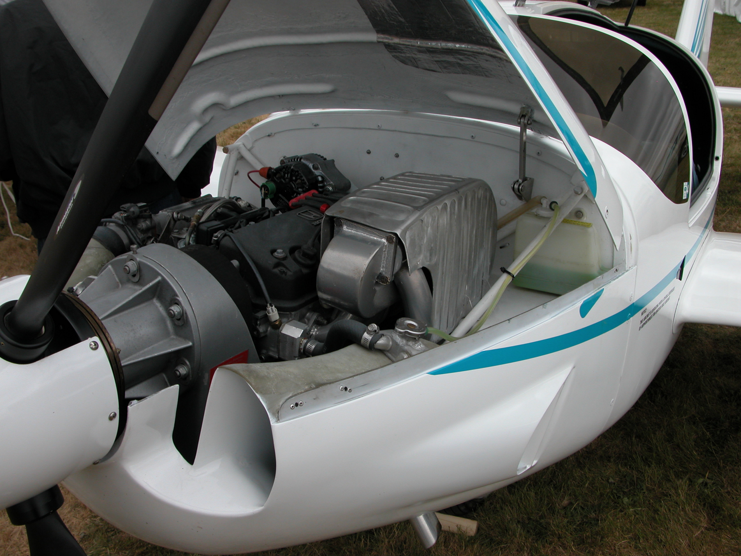

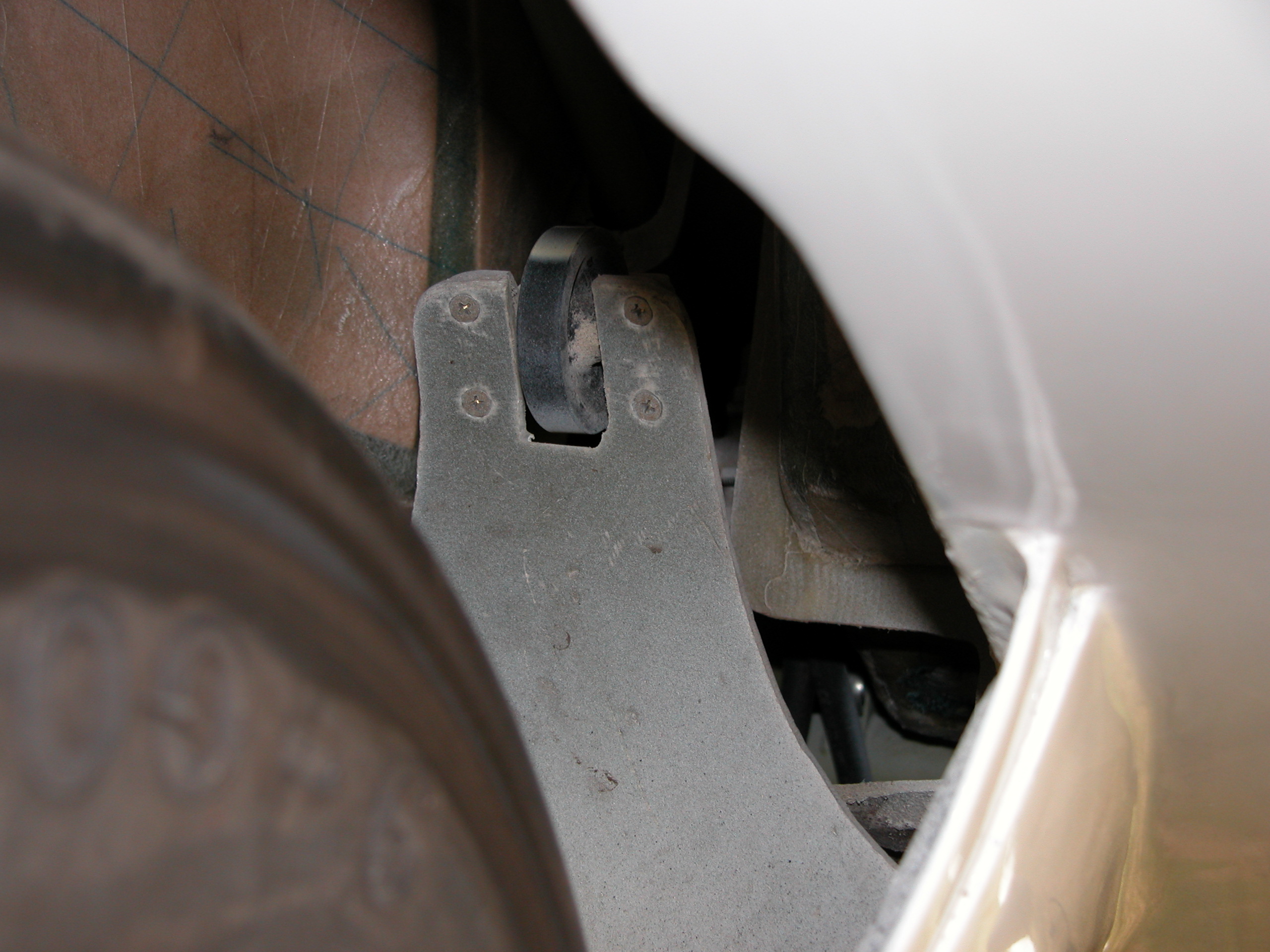

Bowman_in_flight.jpg Alex Bowman in flight. DSCN0091.jpg Note split intake ducts to radiator and engine intake. Starboard side of engine compartment w/ cowling raised. DSCN0092.jpg Note split air intake for radiator cooling and engine comparment cooling; note raised cowling strut; Port side of engine comparment w/ cowling raised; view from front. DSCN0093.jpg Note duct from rear of radiator to side exit; note second exit for engine comparment cooling air; note muffler and heat shield. Port side of engine comparment w/ cowling raised; view from rear. DSCN0096.jpg Note fairing for mono begins along underside of cowling; note first retractable piece of fairing attached to landing gear strut; note second retractable piece of fairing aft of monowheel, and extension of fairing along bottom of fuselage. Three piece monowheel fairing. DSCN0098.jpg Note roller engaged by tire as wheel retracts and brings second retractable piece of fairing up into in-flight position; see in flight photo. Detail of retractable fairing.
