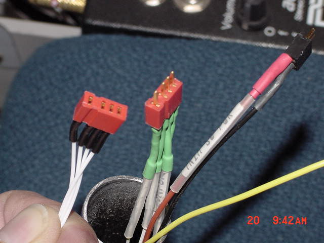

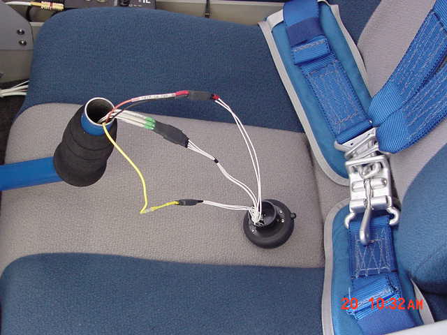

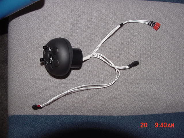

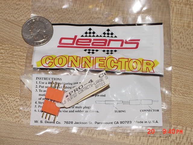

Subject: Mini Connector Pictures Description: DEANS connectors (from R/C models) were used on a MAC grip. They come in 2/3/4 pin connectors (maybe more). Wires are soldered to pins, then heat shrink is used to hold connectors together. Connector tension without heatshrink is very good but heakshrink over them works very well.
