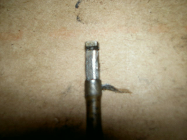

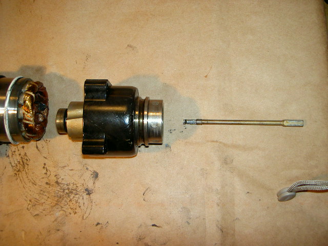

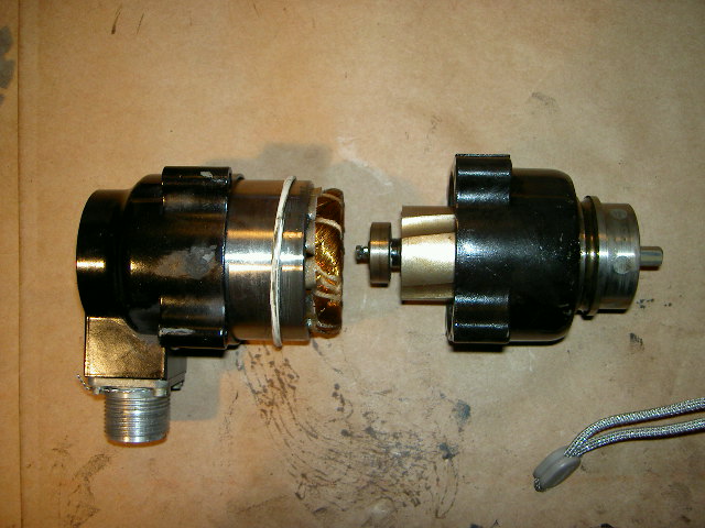

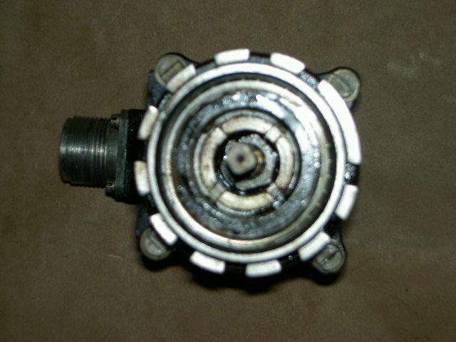

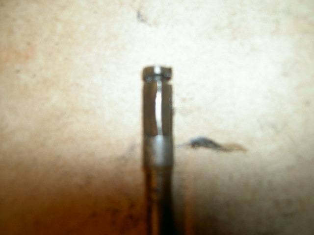

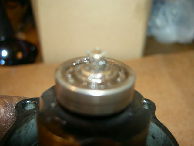

The photos are of my Tach Gen from a Yak 52 M14P engine. It shows the dismantling of the unit to show the failure of the unit due to wear. I have tried to take pictures that show the problem. The symptoms of failure were a pulsing Tach followed by complete failure in both cockpits.
