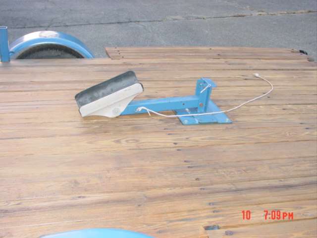

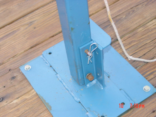

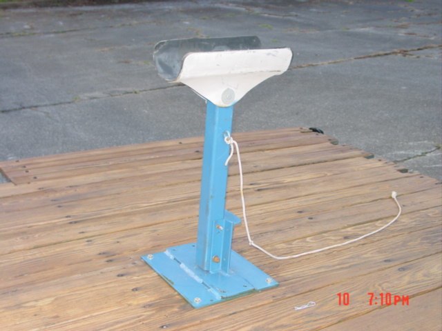

Subject: Tube Support for Kolb Description: A few photos of a tube support I use when transporting my Kolb. It stays folded down until I get the folded airplane on the trailer and then I pull the attached rope to set the support upright. I then insert a pin to lock it in-place. Made from a spar tube cut in half and a few pieces of steel tubing. Has worked great for many years. -George Murphy
