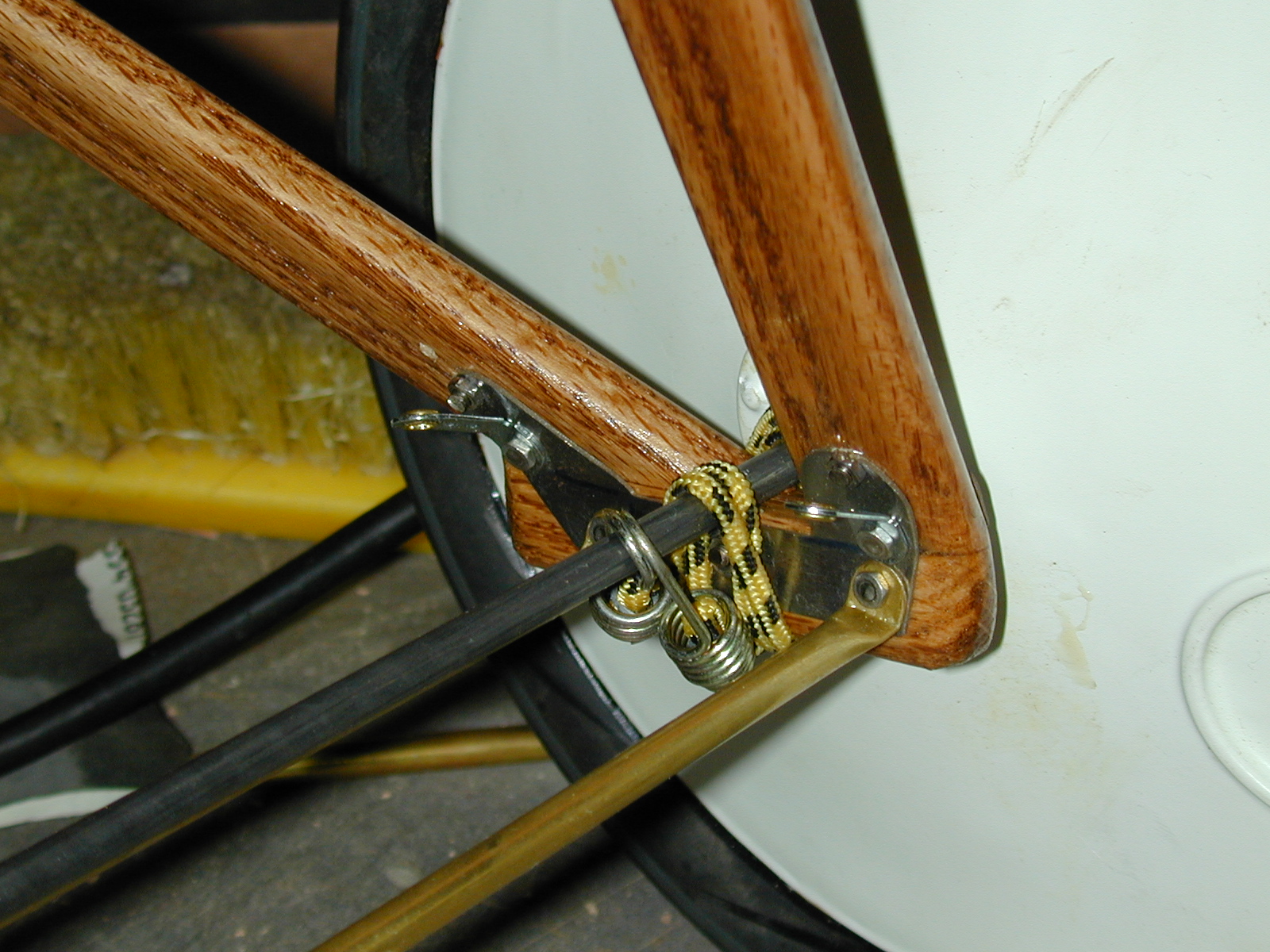

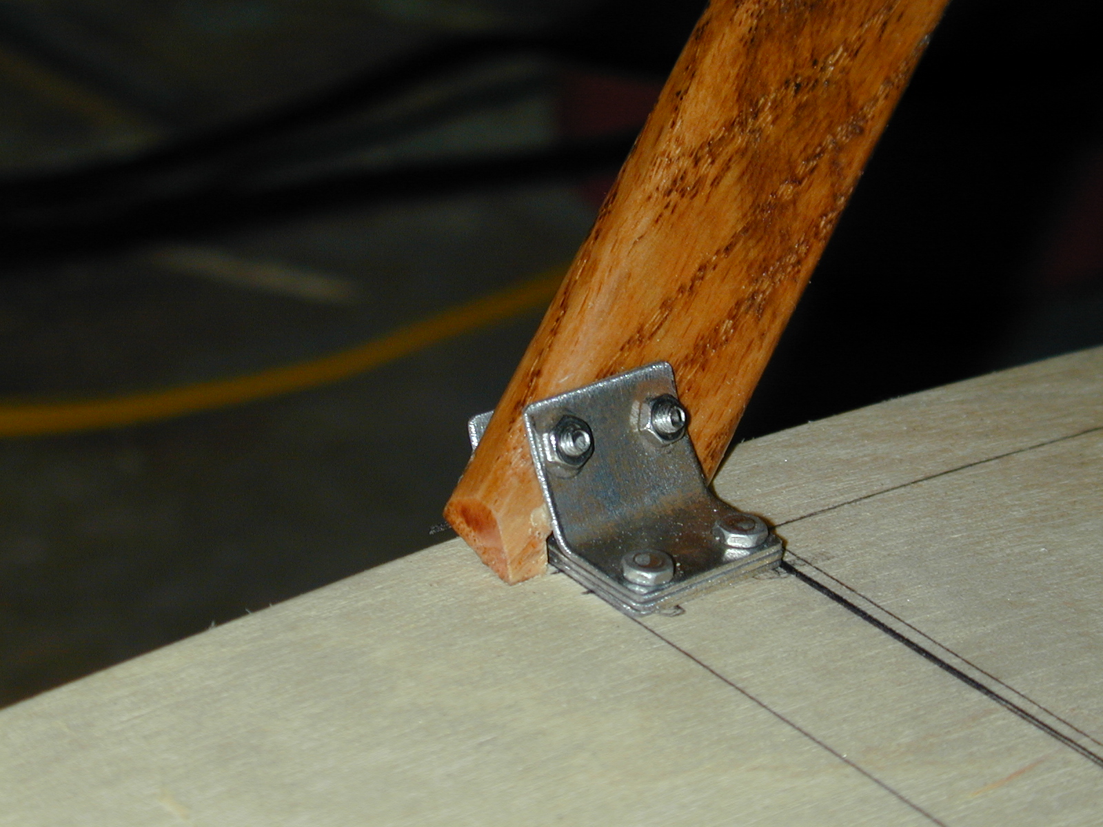

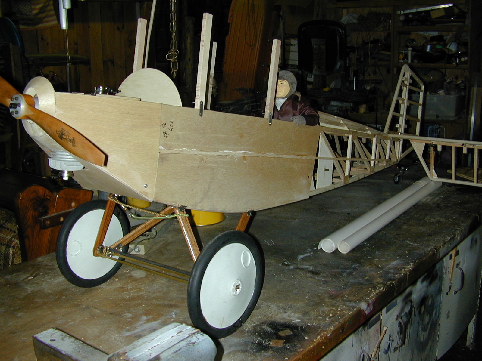

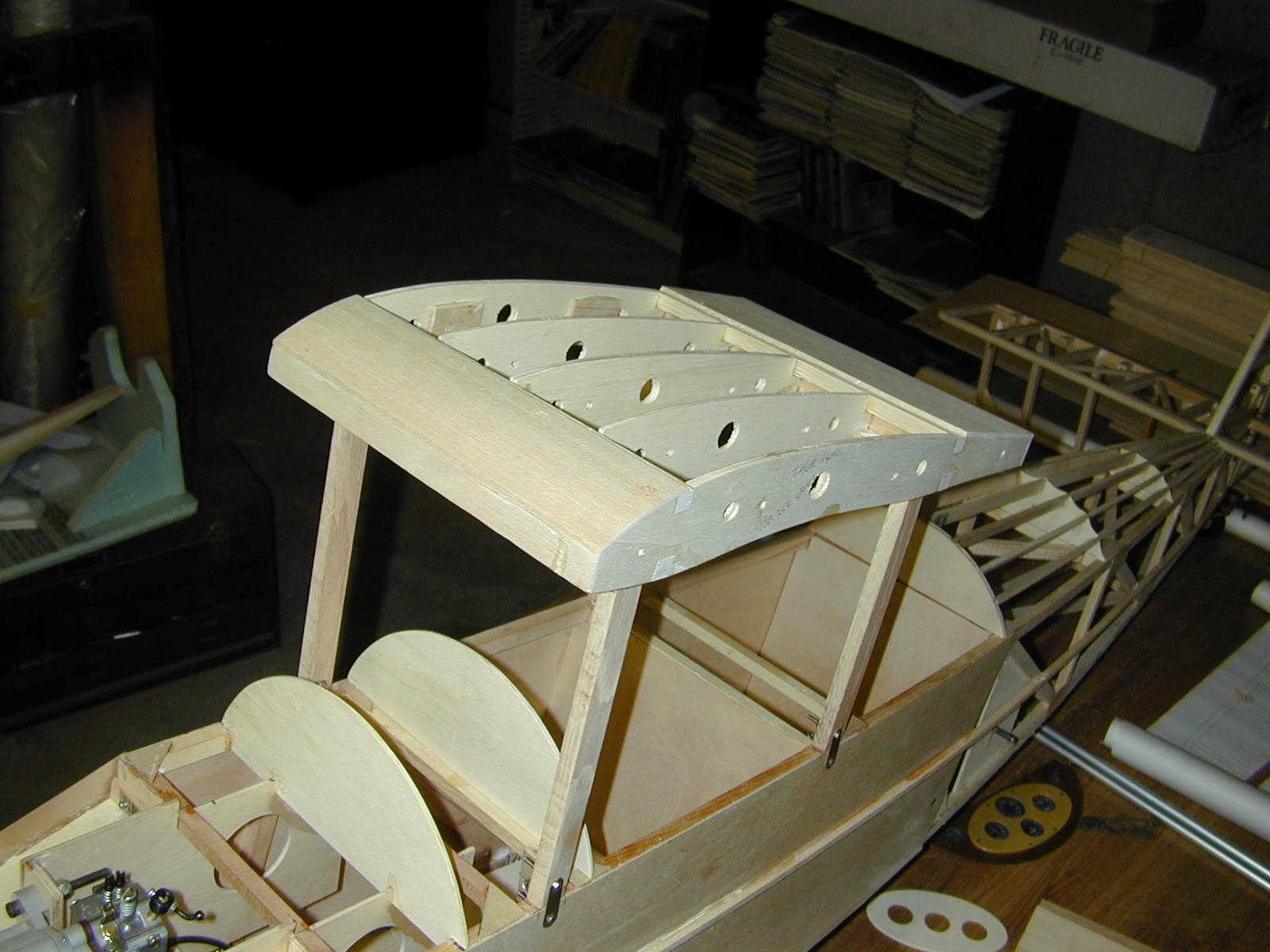

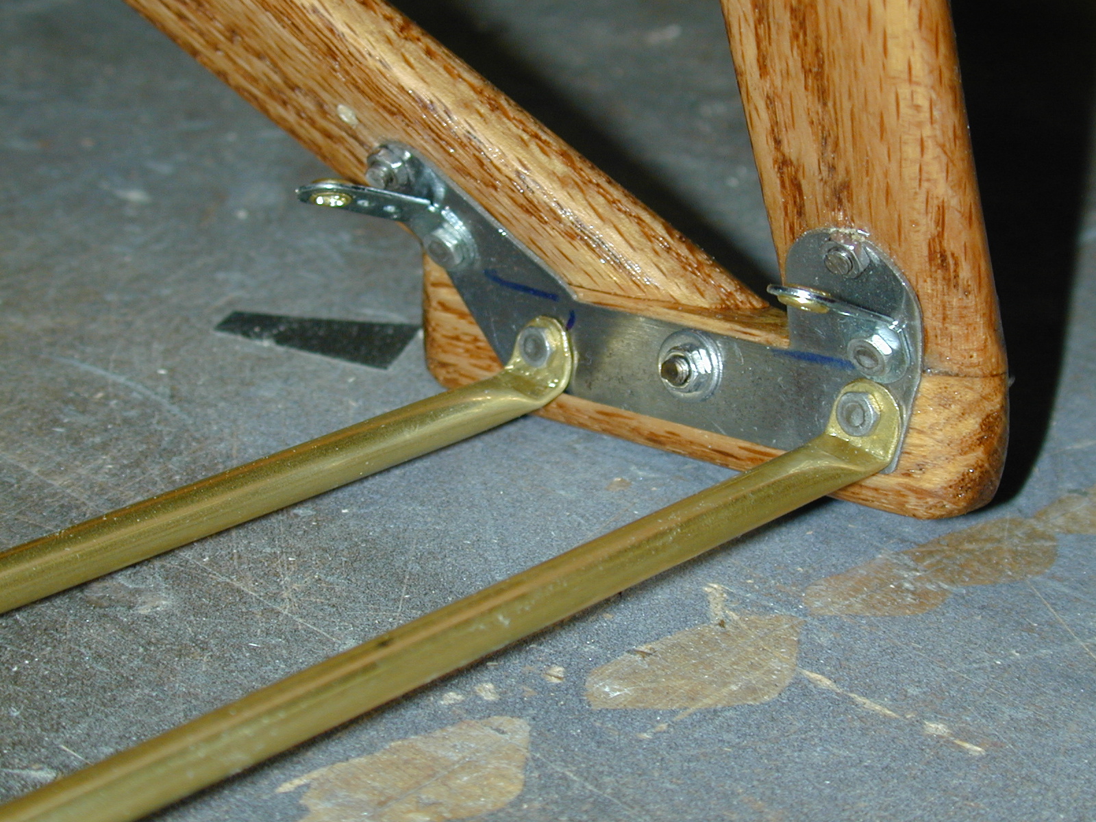

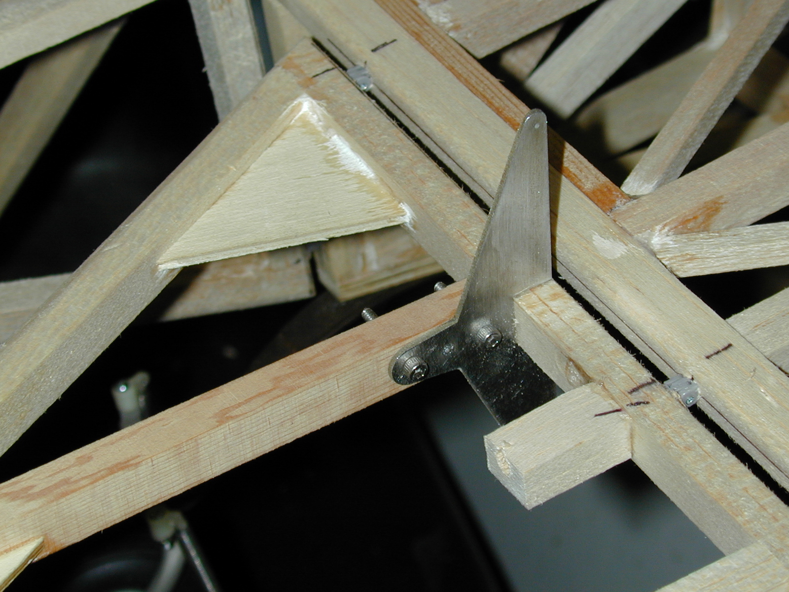

Subject: 1/3-scale Aircamper Model from Full-Sized Plans... Description: Built from full-size Piet plans including much of the metal attachment fittings and hardware. Power is a ZDZ 40cc 6HP engine. In progress. Full-size aircraft is next on the list of projects. The model is made with same materials as full size. Covering will be Stits and Poly Tone paint.
bench_top.jpg Fuselage Bungee2.jpg Bungee Gear Attachment cabane_attach2.jpg Cabane Attachment cabane_attachment.jpg Cabane Attachment Center_section.jpg Center Section engine2.jpg Engine horn.jpg Control Horn landing_gear3.jpg Landing Gear landing_gear4.jpg Landing Gear Panel1.jpg Instrument Panel
