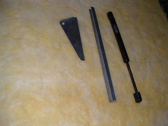

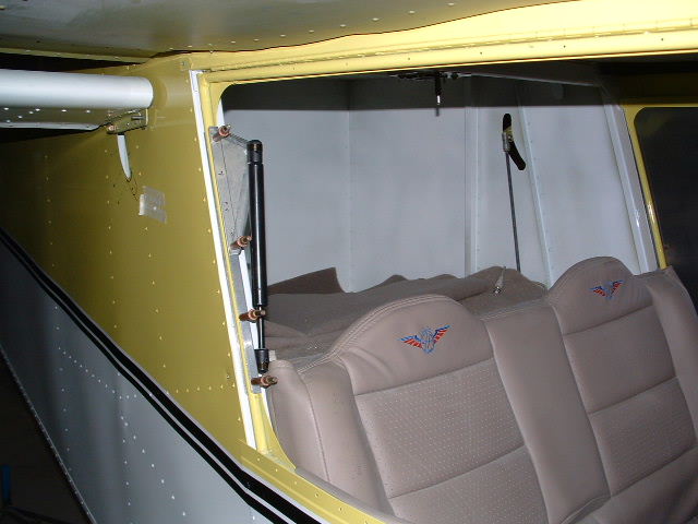

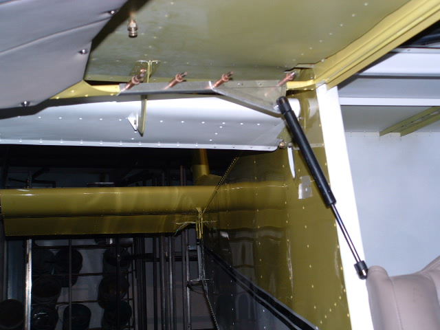

Subject: High Pressure struts installed in 701 doors Description: We used a pair of struts that a friend didnt used in his Kitfox doors, so I dont know where they sell them. We made a doubler channel from some 6061-t6 scrap for the window tube, just in case, and the window triangle support to have the closed strut inside the cabin, so it will work as a pressure lock when the door is closed. Works perfect and are smooth.
Dscf0090.jpg Parts Used Dscf0092.jpg Installed, Door Opened Dscf0093.jpg Door Closed
