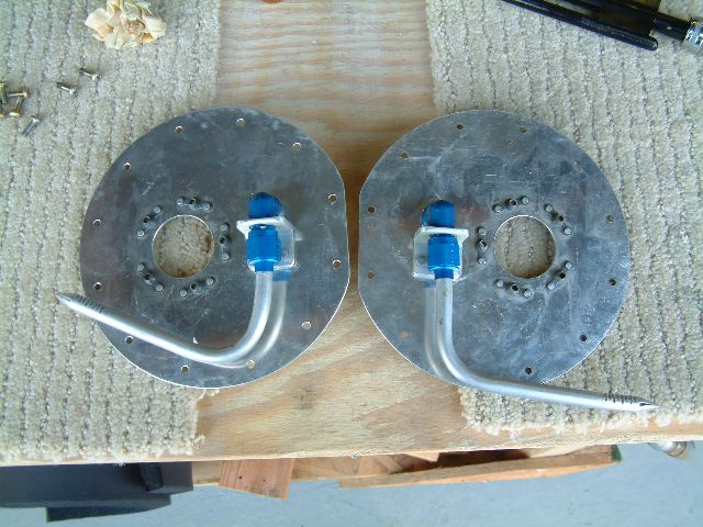

Submitted By: hollandm@pacbell.net Email List: RV-List,RV6-List,RV7-List,RV8-List,RV9-List,RV10-List Name: Mike Holland
Date: May 2 2005
Subject: Quickbuild Fuel Pickup Issue Description: Quickbuilders check your fuel picup tubes. Mine came like the one on the left. They must be bent to approximately 90 degrees, like the one on the right, or approximately 3" of fuel will remain unburned in each tank.
2005_0417_121727AA.jpg Photo 1
