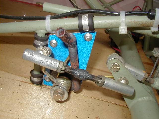

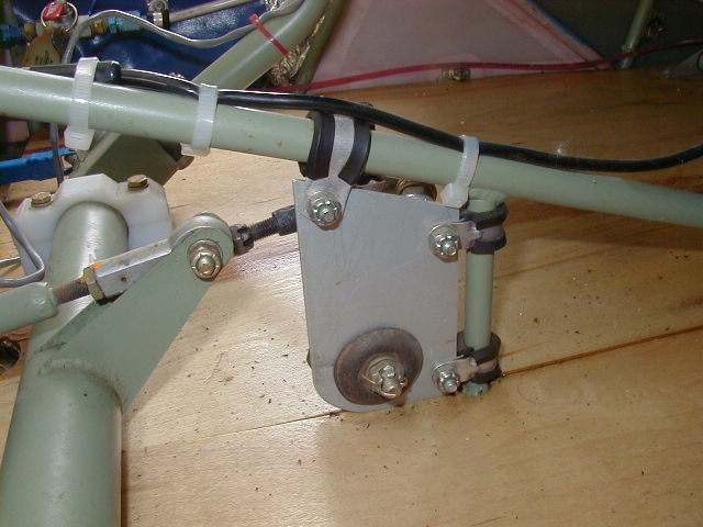

Subject: KF III Elevator Trim Description: KitFox III elevator trim made from a lawn mower thatching blade spring. The linkage to the torque tube is two carb control ends linked by a rod made from welding two socket head machine screws together. There is a leather pad between the large washer and the mounting plate. Tension is adjusted with the castellated nut on the through bolt. The short dog-leg arm is the control, forward for nose down, rearward for nose up.
KF3ElevTrim1.jpg KF3ElevTrim1; Left side KF3ElevTrim2.jpg KF3ElevTrim2; Right side
