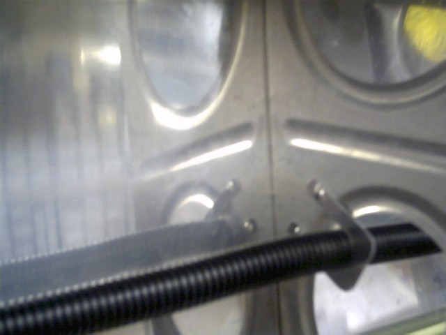

Subject: Bracket for Wing Wiring Conduit Description: hole about 3/8from one end and cut a slot to the other end that is tangent to the sides of the hole. Slip the bracket onto the conduit at each rib and rivet to the ribs. The conduit clears the pushrod to the aileron by about two inches and is straight.
image001.jpg Conduit Mounting Bracket
