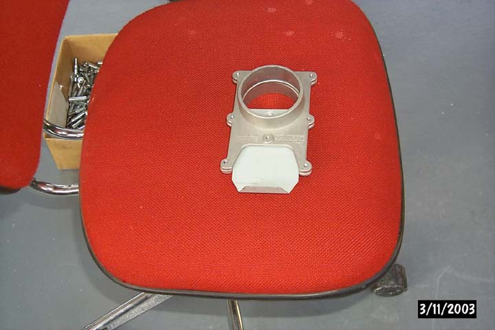

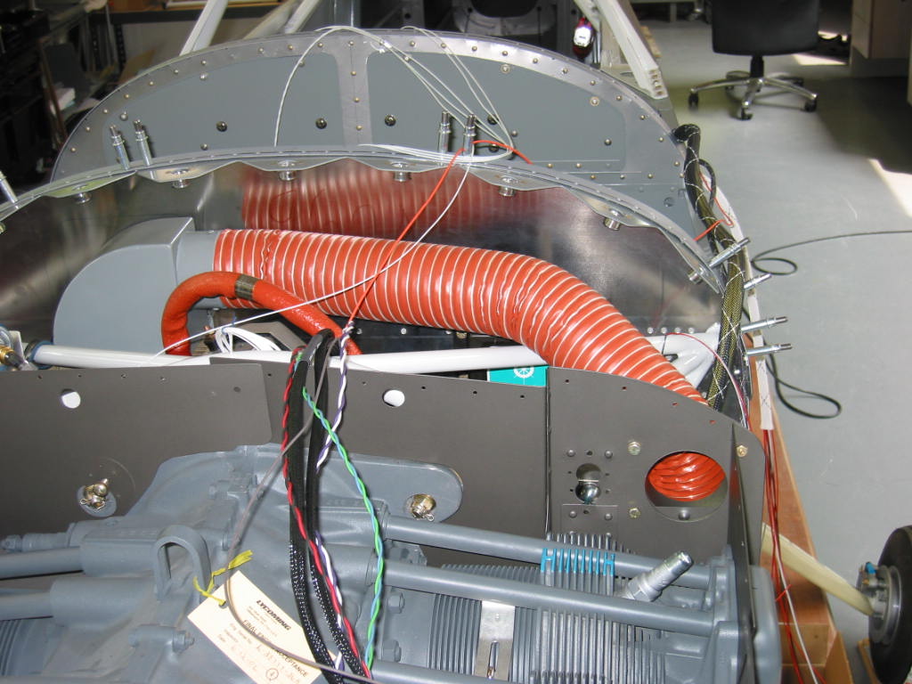

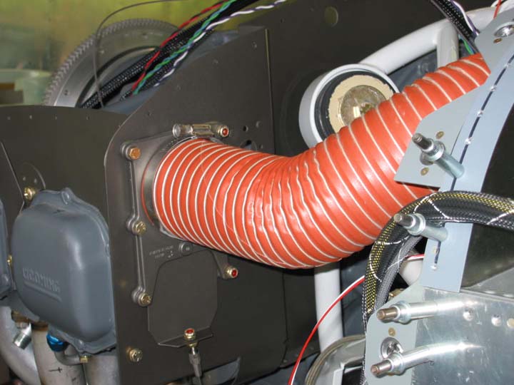

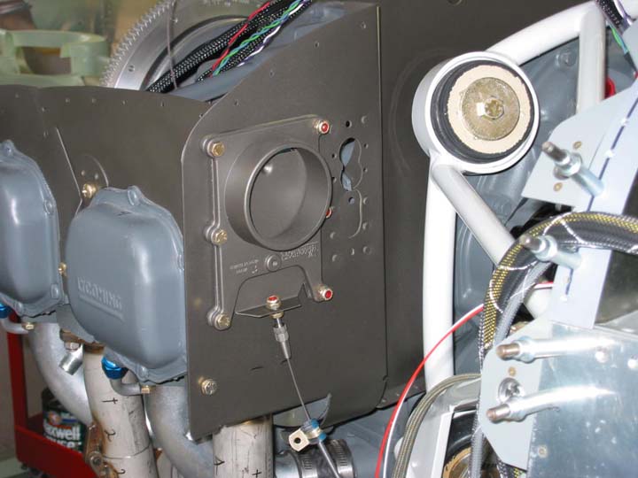

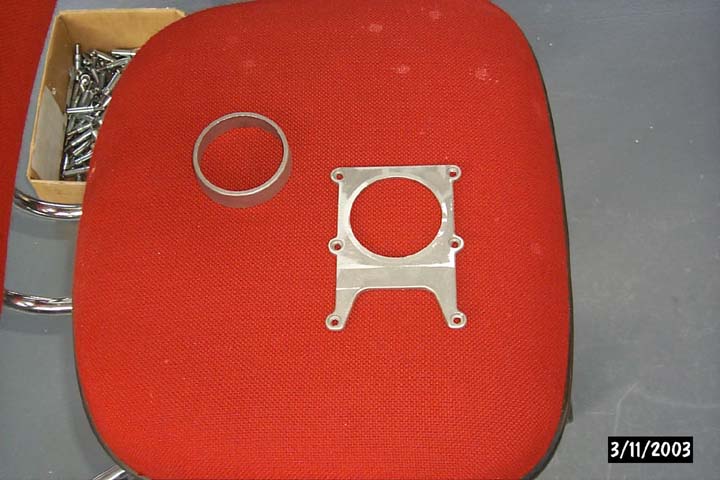

Subject: Oil cooler door Description: I purchased a 3" gate valve for a dust collection system from Grizzly. I modified it by removing one of the collars and mounted it on the aft baffle, left side. My engine is a Lycoming O-360 with the oil cooler mounted on the firewall. I use a push-pull cable to control the door.
gatevalve.jpg the gate valve modgate.jpg modified oilcooler5.jpg view from the front oilcooler7.jpg scat tube in place oilcooler8.jpg mounted to the baffle
